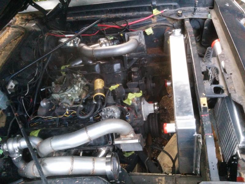

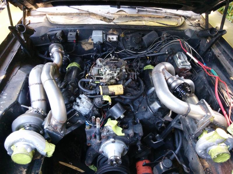

Here are a couple pics from about 2 weeks ago. I was getting tired of working around headers in cars, one reason I went the turbo route. So much room in a b body was able to make all the exhaust piping easy to pull off, even able to use head studs on both sides. Just need to pull one spark plug out on the drivers side to pull the down pipe up and out. will be wrapping the pipes though, the 3 inch downpipe on the drivers side is a tight fit by the brake booster, engine head, and electrical wires. Have new drivers side water pump, 140 amp alt and brakets fabbed and mocked up and most intake plumbing,bov ect, but somehow lost the pics.

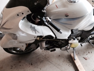

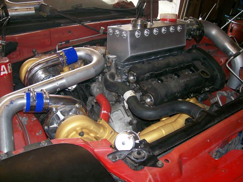

ive never boosted a Mopar V8, but ive boosted alot of other shitz..car **** and nibbler puppy 053.jpg
I don't think you will be off boost much, lol, twin turbo b-body is going to have enough load to get them twisters spooling pretty fast...
I would put an af meter with an alarm, I used zeitronix when I built my turbo motorcycles (420 hp daily driver hayabusa 1300cc no stroker no over bore and I built a 508 hp hayabusa stroked of course, 500hp from an engine that weighed under 150lbs!!!)
I like to stay around 9.0to1 for turbo engines , I know you are thinking "well I dont want it to be like a v6 when its not boosting, BUT figure it this way, when you get on it, you are going to build pressure, and when you are not into it you still have 440ci making its power, I had a twin turbo 291 chevy engine in a camaro, the car with the gate wired open would burn the tires off through 4th... A well built 440 even at 9-1 is going to have plenty of sack, you are going to like that lower compression ratio when it allows you to boost another couple psi and when you figure each lb of boost is making you -20 hp, lol you are going to want to keep tuning that spring...
Cylinder pressure is important to keep your eye on, when it comes to building a tame engine that will behave well and last long, heres the best advice I can give..
1-buy a turbo grind roller cam, or minimum of a turbo grind, roller sets are $$$$
2-9.0 to one, thats what to shoot for if you are not racing, racing will be much lower.
3-a/f meter, don't be afraid of electronics, they are going to make your life much easier, I started running water injection, then meth, then I smartened up and ran the fuel it needed instead, my turbo 291 chevy (was a crower 2.850 crank with a 4.030 bore) that was carb'd ended had 8 injectors drilled into the intake runners, mega squirt made a unit with a wide band and stand alone secondary map so that when the motor was going lean the injectors fired the extra fuel, this allowed me to run a much smaller jet size in a large cfm carb, so I was using a mechanical fuel pump for the carb and a walbro for the secondary injectors, it was a lot of trial and error but I found the extra injectors the way to go...
I only did that one turbo v8, the bikes were much easier, I wanted to do a 3.8 but thats been done to death so I destroked a 350, it was EXPENSIVE, but the she revved 8600 volumetric efficiency was off the charts, lol, 225 cc heads, spring oilers, belt drive, pickup ignition, 2 huge coils, titanium valves, the rotating assembly was like 9lbs lighter than a 350, lol.. It actually felt dangerous, we started with an automatic but the rpms were burning the pumps up went to a manual and the car was just insane, I don't know why chevy never made that engine, I had to get custom grind cam, pistons, I think the rods were 6.250's!!!!
Anyway, good luck, I hope some of my info helps, its been a while since I did a build but I still have the ole' turbo bike, I don't ride it much, but a few weeks ago I fired it up for a blast around town... Heres some pics, you can see the 02 sensor in the dump pipe, it gets a bit of dillution but when I had it up towards the turbo I was cooking them, thats a zeitronics system, and I have an egt sensor in there too, them numbers can get scary in a hurry, lol... Bike is 400+hp on pump gas, weighs less than that in lbs, lol...

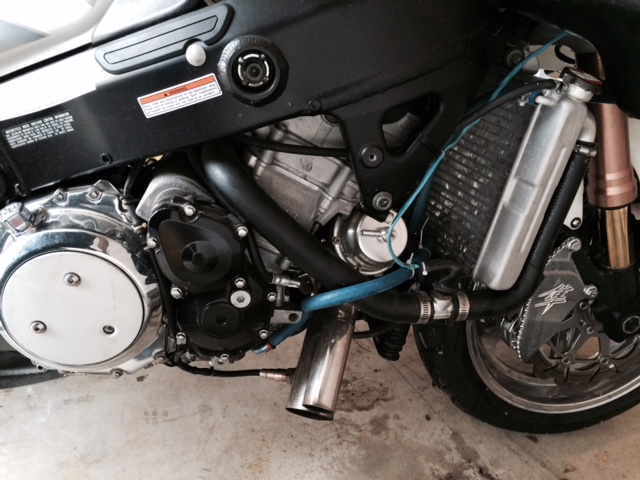

A 400hp daily driver sprtbike is nuts, I have ridden an r1, cant even imagine well over twice the hp. I can tell you have very good self control, and a cool head because, well your still alive. The bike looks well packaged, can't even see the turbos.
Your advice about 9 to 1 cr is well recieved, perhaps I should aim for there, it is on the lower end of my window. A 13 cc dish piston, .020 in the hole, with a .060 cometic head gasket should get me there. Your right, a 440 should not be to doggy even at 9 to 1, and if the turbos spool quick, with the right converter it should not matter anyway. Usefull comment about the weight of the car loading the engine and helping spool the turbs, didn't think of it that way but it makes sense.

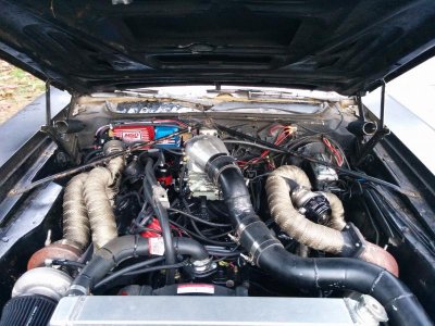

Just wanted to update this thread a bit, Car is on the road, maybe have 300km on the new setup so far. Lots of things to clean up and tidy, and many other things on the list to do.
Did go with a girdle, had to modify my oilpan to clear the K member. One thing I have noticed with the girdle, I can carry about an extra litre of oil, added bonus.
Moved the MSD 6530 to the trunk to keep it away from the heat, Was getting roasted where I had it before, just to the left of the coil. I do like the MSD 6530, easy to use, Distributor is locked at 34, and I am pulling 14 degrees until 1000 rpm, then ramping all the timing in by 2400rpm. Pulling 2 Degrees per lb of boost, I will keep it conservative for the time being.
After breaking in the cam, Had an exhaust leak on the pass side, the leak was directly facing the valve cover gasket, so had to re-do that as well. There was a small dip in the flange surface on the exhaust header, had to weld it up and grind it flat. used mr gaskets make your own exhaust gasket material, installed along with ultra copper sealant, and its working well.
Anyway the CSU carb was way off in the off idle and cruise dept. I know in my spec sheet I submited to get the carb built, I spec'ed a 2400rpm torque converter, though I am still using the stock one. The wideband numbers are good after 3000rpm and under boost, but initially I had to have the idle AFR at 9.5 just to make it drivable, and I would still see 17.5 just off idle. Setting the Idle up to an AFR of 11.5, I would see The wideband go off the scale on both sides, 9.0 and 19.0, all within a 100 rpm and slight throttle change. Transfer slots are adjusted properly.
Drilled the IFR larger, took a few steps to get up to .039. Same with the IAB, they are now at .094. Changed pri & sec squirters to .040, though Its not a squirter problem as I can hold it in the dead Zone, A very lean spot off of idle. It is much better now but the dead spot seems to come and go a bit, along with where I have my idle AFR set and what my cruise AFR's are.
The IFR's are in the top of the metering block, thinking of moving them to the bottom of the metering block and to see if that helps. I have read that when the IFR's are on the top of the metering block the performance can be inconsistant and crappy, especially in hot engine bays, which mine certainly is. Wondering if anyone here has heard of this? One other thing I may try is to bevel the underside of the throttle plate where the transfer slots are. Perhaps the carb is getting to hot.
Kevin at CSU is a good guy, may give him a call to see if he can help me sort this out. May leave it alone for a couple weeks, so I can get some other things done.
Had to put a heat insulator under the carb, hood clearance being tight I bought a 1/2" and milled it down to just over 1/4" with a grinder and sandpaper on a flat bench, took a little more off of the base of the carb hat and seems to fit fine. Carb was getting pretty hot. Seems after I shut the car off fuel vapours fill up the turbo intake pipine, so 10 min later I need to crank it for 7 seconds to get it to start, the insulator has only been on one day son well see how improved it is. I will prob have to figure out a way to vent the intake piping before starting the car or after I shut it off. It's Winter here right now and if I am having these problems now, they won't improve by the summer.
My upper rad hose is a Dayco 70539, any know of a different part # that has a more direct route? , You can see how close this one is to the hotside pipe, hence the extra layer of silicone.
View attachment 273300View attachment 273301
