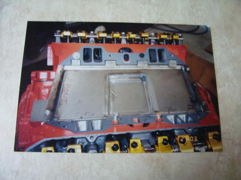

this is a picture of a picture so i'm not sure how clear this will be. anyhow, its the valley pan i made for iron heads on the 440 in my 65 coronet. it works real good.
