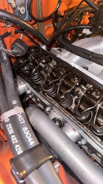

So I recently purchased a 1970 roadrunner and after only driving it half a dozen times and less than 300 miles I’ve blown a valve coming out of a roundabout at around 3000rpm.
Devastating is an understatement.
I am yet to pull the head off this weekend to see how much damage I am in for. I need some advice on what to replace and what combination of parts work best. I am in Australia and can’t seem to find any mopar engine experts here.
I am hoping piston isn’t damaged and can fix everything top end but at the very least I want to know best heads cam and intake manifold to use while it’s off-road I might as well beef the engine up and make it more reliable.
Look forward to reading any pointers. Thanks everyone.

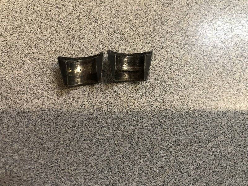

I would look real close on those keepers and retainers. There could be a mis-match.
That doesn't look like a valve failure. It looks like the valve locks broke. Need a picture of the valve stem and a unbroken pair of locks (keepers). There are stamped locks or machined locks. With machined locks being a better option. At this point it's hard to tell if A; the locks plain failed, B; they were not installed correctly, C; the locks are the wrong style for the valve stem size and design. D; the lock angle and the retainer hole angle didn't match (7 degree with 8 or 10 degree).

Thanks mate I will post more photos once the heads off.
You dropped a valve at 3000 rpm. Unless the engine stopped instantly, you’re not going to like what you see when you take that head off. As Doug advised, look over your retainers and keepers. Make sure they match themselves and the valves. Might want to check that connecting rod for straightness also.

As said, looks like the keepers failed.
More than likely this is the result of some unhappiness in the valvetrain.
Careful inspection of the 15 other sets of keepers, and their related parts should help shine some light on if that’s true or not.
Also, if the cam lobe of the affected valve is going away, it can cause things like that to happen.
I’d also look for witness marks of contact on the outer edge of the retainer and the underside of the rocker.
Not only on the failed one, but the other 15 as well.
My experience is that it’s very rare to have keepers fail on their own.
However, if the valve, keepers, and retainer don’t all “lock” together, It usually doesn’t turn out good.
Even when the “inter-fit” between the parts is good, if there is high enough degree of hammering going on(from something like a worn cam lobe or dead spring), the tangs can get sheered off.

It appears the valve stem is still in place.
Of course, the head of the valve may not still be attached.
The picture isn’t very clear, but the pushrod socket of the rocker looks like something may be going on there…….which is another indicator of possible valvetrain unhappiness.
The retainer at the rear looks like it might have a witness mark where it’s been contacting the underside of the rocker.
Here’s an example of keepers that had the tangs sheered off…….
There no indications of any problems on the other 15 valves/retainers/keepers.
The valve spring on the position that failed was down 30-40lbs from how it was installed.
The other 15 were still fine.
Before these keepers finally let go, they had moved up the stem to the top of valve, and there are witness marks on the top of them from contact with the rocker arm roller wheel.
So, the failure is a result of lack of control of the valve…….. because the spring lost a bunch of pressure, and that hammering finally won the battle over the tangs of the keepers.
The unanswered question remained……. Why did that one spring give up?
Yes agree the valve is still there, just remove that one pushrod swing the rocker out of the way and try to see if the valve still moves freely.
