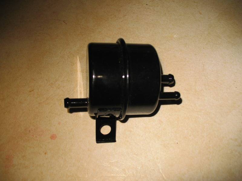

Where do these repop vapor separators get bolted to the engine?
Check it for the restriction before you install it....The return line should be restricted, I seem to recall the orifice should be .060... Allot of the repo's are closer to .125 so your fuel pressure hovers around 2 psi.....
If it's to big put a Holley carb jet in the return line...

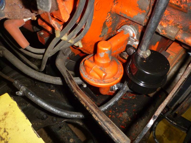

the outer bolt on the fuel pump
I tried to put one on years ago, following what it looked like in the manual on the timing cover, but it wouldn't fit. I never tried the fuel pump, and that makes a lot of sense.
