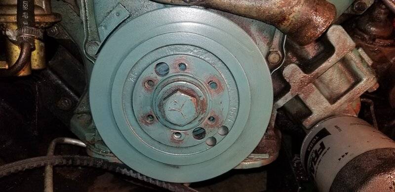

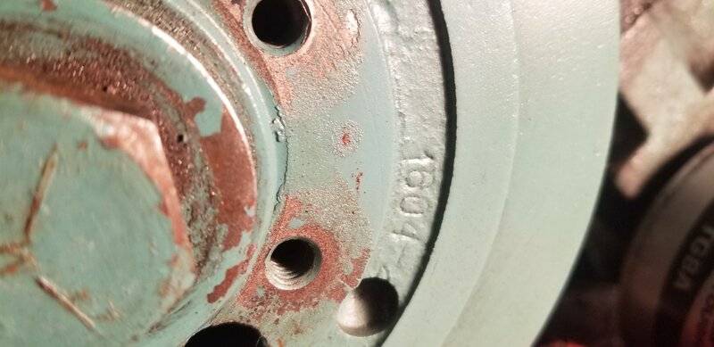

I'm chasing down a rythmic vibration. Had tires road surface balanced, which got rid of a lot of vibration at highway speed. But then noticed car vibrates in park revving engine above 2500 rpm. I researched harmonic balancers and believe engine has correct balancer for year. Is there something I should look for at the flywheel or torque converter?

Need to know the crank type, then see if the front/rear balancing is correct.
I've had a cast crank with internal balancer and no TC weights.. put it right and it was good.

Well, actually it "could" be the trans torque converter. With ALL accys/belts off, engine mounts confirmed good and tight, a vibration would be between the vibration damper and the torque converter. I'd check those two definitely before going into the engine. Change the damper, check the flex plate and the converter for cracks, loose bolts, etc.
Well, yes, The rotating assembly IS also the torque convertor! It's bolted to it! But that's where it stops. Change the
damper to what?
