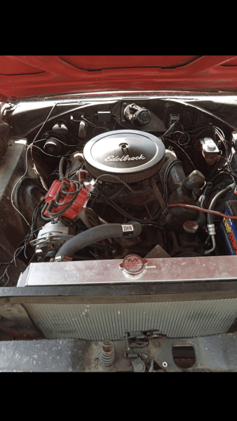

Hey guys,
I’ve got a ‘68 440HP stock motor. Built Jan 22 by 2nd shift. Im planning to swap Cams and maybe some head work if i can find a shop near southern Oklahoma.
I dont know which Heads were used in 1968. Motor runs great, no issues, only add ons to my knowledge was new ignition and headers.
To be totally honest I don’t understand Cam durations yet but I’m wanting a Cam with plenty of lope and staying under 6k RPMs. I dont wanna push my luck too far and damage the motor, just want a aggressive responsive street car to make some of these GT Mustang owners wanna go sell them.
I have a 727 transmission, Edelbrock Performer 600cfm, currently have 2.76 gears from the original 318, planning on 3.55 sure-grip swap. Running 295/50r15 tires.
Any suggestions or recommended changes?

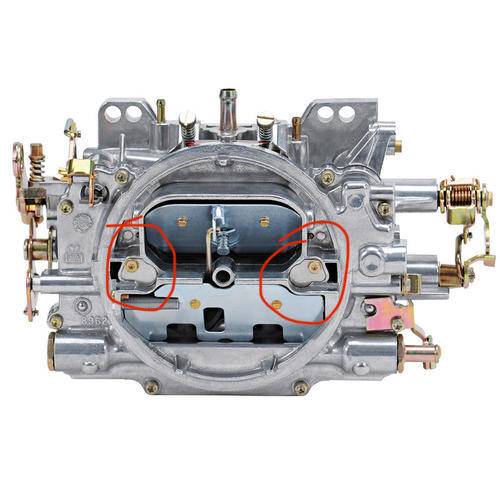

Or if you can afford it and hit the easy button. The Edelbrock avs2 800cfm is a good choice too. Buy the tuning kit that comes with it, it’ll have a chart to help based on your afr numbers, most of the time it’s just metering rod changes, and you don’t even have to take the entire carb apart to do that. Just loosen these screws, pull the cover to the side, and make your change.
