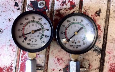

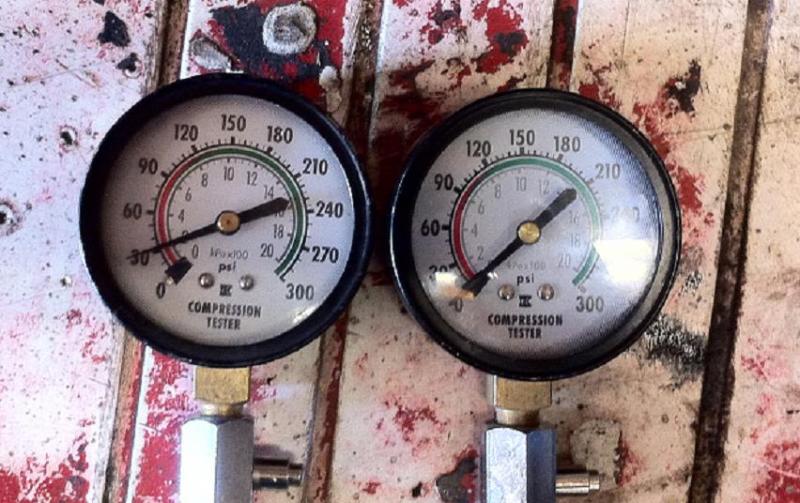

I decided to make the switch to new adjustable roller rocker arms in the 1.6 ratio. I installed them on the left side first. Just for the heck of it, I decided to recheck the compression numbers. When I went to grab the hose and guage, I noticed this:
The guage on the left STARTS at 30 PSI !! I never noticed it until now. What a rookie mistake!
I rechecked the compression numbers with the guage that starts at zero.
Dwayne Porter was one guy that suggested that I try using another guage to see if I had made a mistake. Now that I am recording numbers closer to what is considered "streetable", I will finish the rocker install on the right side. I have new spark plugs and wires to install and a new 6 quart oil pan. For now I'm hoping to get it to run without spark knock. Later I will consider steps to increase the power.
