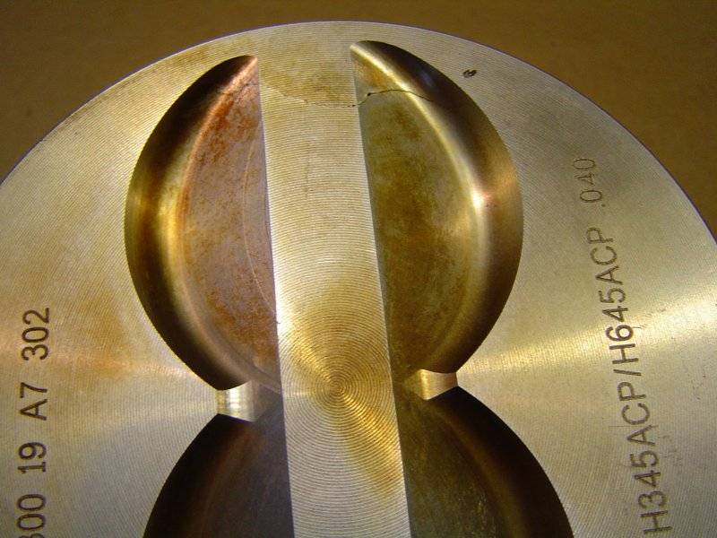

Oh I'd be under budget, a gasket kit is 150$ and rings are another 100$I have those pistons in several 340's. I wish they would make a factory style cast oversize in L+R and with valve pockets on one side only. At that cost, you might come in at or under budget.
A minor piston weight change probably won't hurt. As my machinist reminded me, "what does the oil, in and on the piston weigh?" Of course some people believe in underbalancing. Weigh both.
I would not add nitrous to a cast piston. But I know nothing about nitrous tuning with extra fuel.
Also, summit says the wrist pins are of the press-in style for those pistons. How does that work with the rod that is bushed for a floating pin?
Only question is do I redo my main and rod bearings? I don't know, some may call Uncle Tony a nut job but he runs one of his motors with all used bearings to "rev freer"
Also, do I need to replace the wrist pins when I replace piston?
