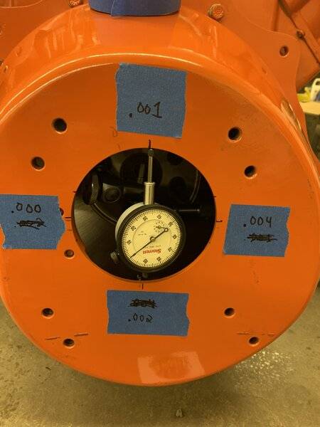

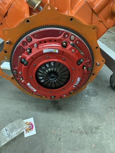

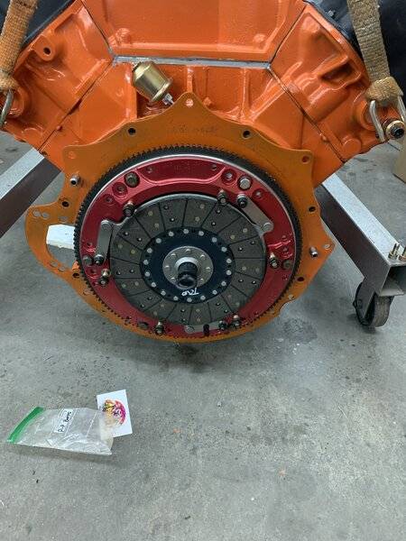

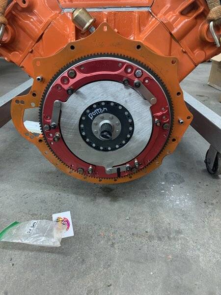

Got this thing reassembled and almost ready to go back on the run stand. Will see if the rear main seal repair worked hope it did. waiting on the clutch to arrive and i dialed in the bell this morning. Used some really nice offset dowels from McRobb performance
Got the clutch and bell housing installed and it’s back on the run stand for round #2.

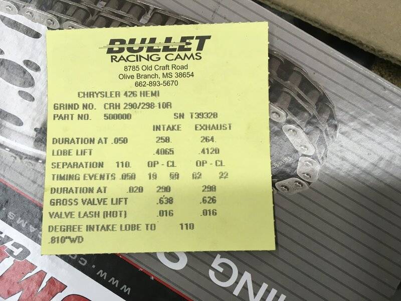

I have it idling at around 1000 rpm and the timing is at 18 degrees initial any lower and it doesn’t want to run. I could maybe get it lower but i don’t want to open the throttle blades too much at idle. It has 22” of vacuum at idle and fairly steady so what say you hemi gurus is 18 degrees initial too high? It lights off instantly and Ray (@HALIFAXHOPS) set my curve to be all in at 32 degrees at 2500 i’ll post a pic of the cam card as well
