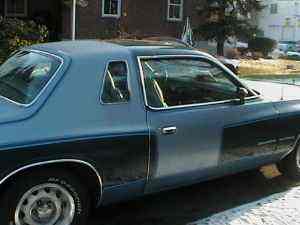

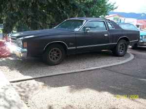

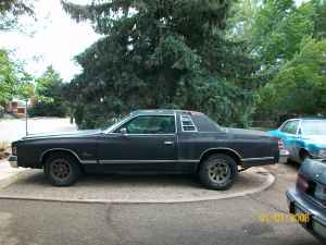

the car is a 1977 XS22 dodge charger SE, 360/904/8.25. factory black/black/black .bucket seats,console,dual chrome sport mirrors,tilt wheel and power windows being just about the only options.front and rear sway bars, disc brakes,11 inch rear drums, pretty basic and run of the mill. it had 68,*** original miles, a little bit of rust,and after sitting for 8 years, a little fuel down the carb, it fired up and drove it home after giving the PO 500 bucks. incidently, it was a craigslist car and she was the 2nd owner and was VERY attached to it,but needed the money.these pics are the actual CL posting pics....

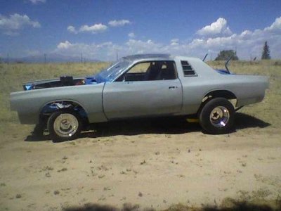

i decided that instead of a restoration or restification as every nice 4th gen charger seems to be getting, i was going to shoot for a street machine type of look. i have never seen one of these cars done up in a "hot rod" fashion so why not. getting sort of a "mock up" look , i tried various rim and tire combos and other little things,just to get an idea of what it may look like before tearing into it.here are a couple "ideas".

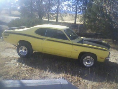

here are a couple of daytona models that,to me , was truly the end of the great paint treatments and the end of an era...most people hate these body styles and well, they have a look all their own and that is why i chose to at least give one a chance...

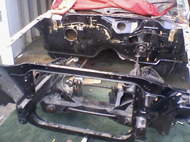

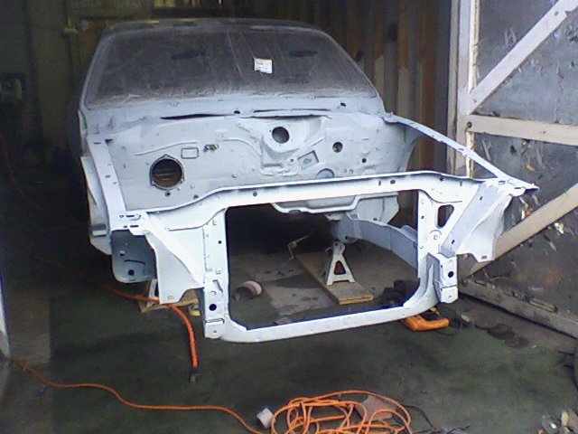

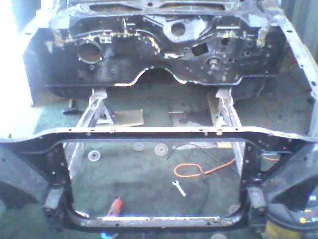

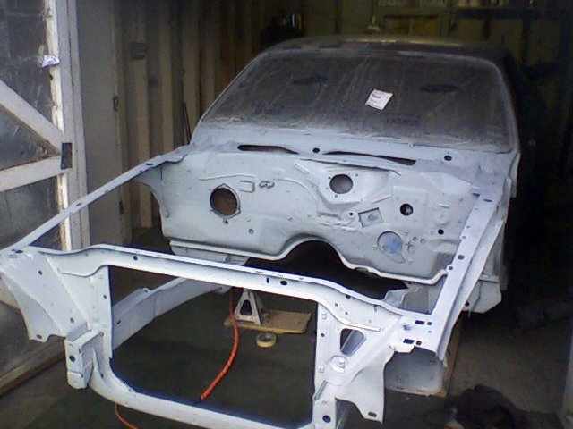

first order of business was to get this thing torn apart and down to metal to see what i was dealing with. luckily ,it was the original paint ,and it had been hit on the rear left side , "fixed",if you will, and only the quarter had been repainted . lucky for me ,it wasnt a hard hit and the paint came off relatively easy.it definitely had some rust issues and there is not a repopped panel being made for these anywhere.i have a buddy that has a farm of 75-77 cordobas and a couple magnums, so i was able to cut out patch panels and get them welded up . again ,lucky in the fact the rust was minimal and i only needed the lower 4 inches on each side.i didnt get many pics of any of this, i was too focused on getting it out of the way and in primer.

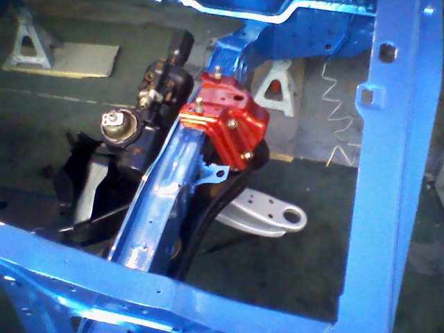

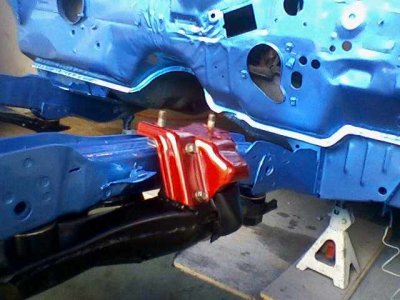

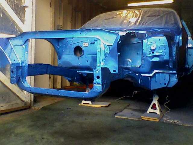

next was the engine compartment. i took every piece of the front to be cleaned,painted or replaced. every bushing and firewall gaskets were replaced using a gasket set from year one for a 74 charger. in 1975, ma mopar decided to give the b body a smoother ride by adding isolator bushings between the k member and the frame rails, the torsion bar mount and the body, and the rear leaf springs and the mounting perches on the axle.all of which are available along with every bushing and ball joint. front and rear sway bars were standard as were the big brakes and front discs.the engine pic is what i pulled out.
this not a rotiseree by any means and like i said a budget ,but with replacing every suspension piece and cleaning and painting, it can still be a looker and function like new. i have seen sooooo many people claiming a restored or great rebuild until you look underneath and pop the hood only to see thousands of miles of nasty,greasy,oily dirty,used up parts,and only a painted body . with limited space ,money and resources, i did not tear the whole thing down,paint and then put it back together.i know this is the correct way to do things ,but sometimes,you do what you gotta do lol. here is the progress of the engine bay.it took many hours of sanding and prep to get this down to metal and primed with y2k primer.

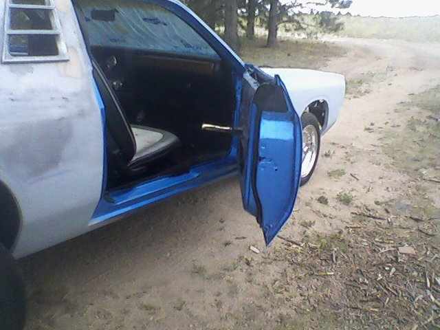

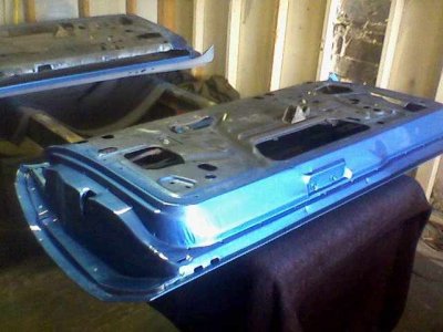

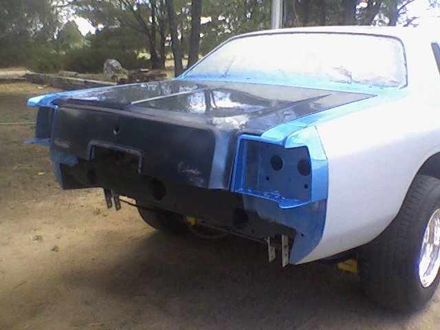

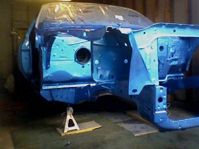

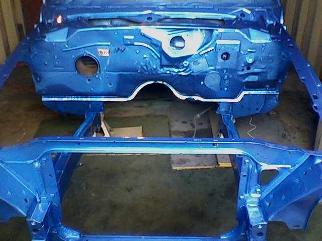

i had come to the decision,that while i like black, i searched through hundreds of color chips and i found a blue that i had to have. because changing the original color isnt going to hurt the value, and these cars dont really have any "value" unless they are an original 12,000 mile example, i went with a TCP global electric blue metallic, medium ,single stage, high gloss acrylic enamel kit. now for some color....i painted the engine bay and door jams and trunk lip, hood latch support and inside the doors all at the same time....sorry for the crappy cell phone pics..

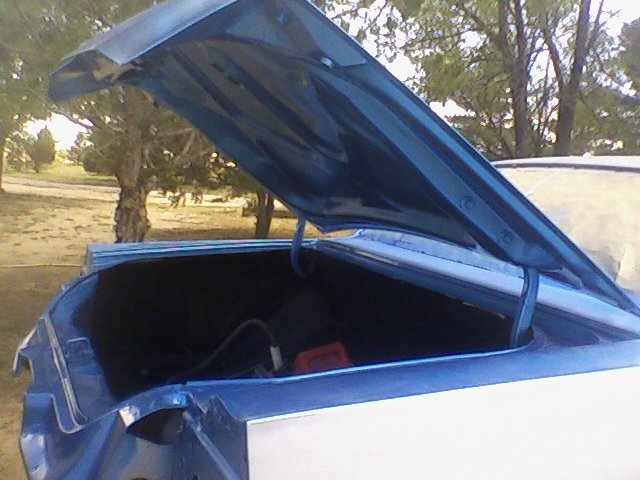

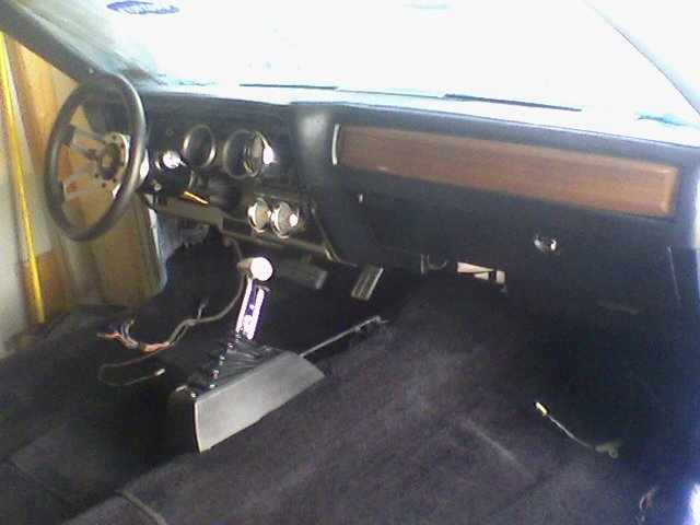

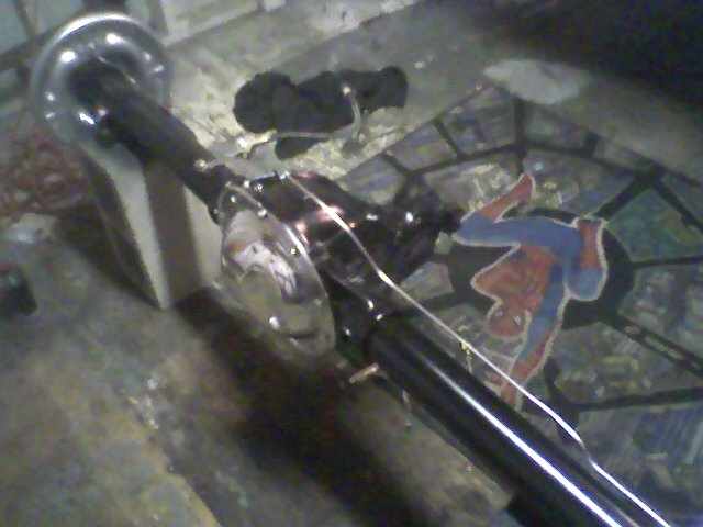

these pics dont do any justice, that blue is an AWESOME color and that TCP layed down like glass and i have no regrets with my choice. the entire under neath was completely re undercoated and there were no rust issues what-so-ever. it was time to start with suspension. at this point i had to decide if i was going to hang all the metal and shoot the body.all the body work was done and well, due to other factors ,i decided to go ahead and put the interior together and hang the rear axle and front suspension.if i had my way, i would have painted the outside first,but there is always next time...

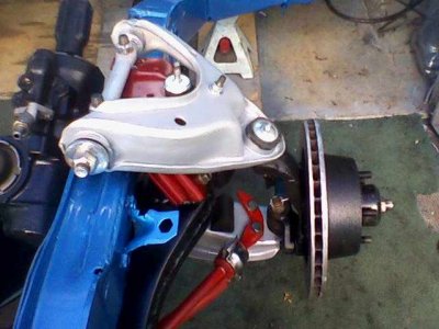

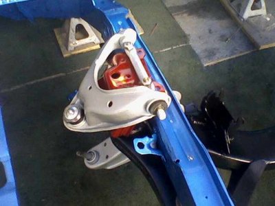

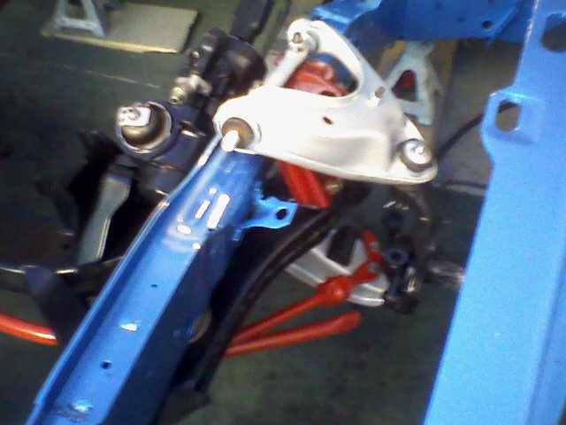

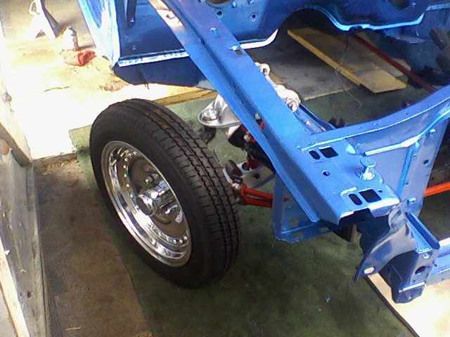

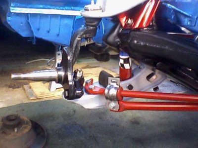

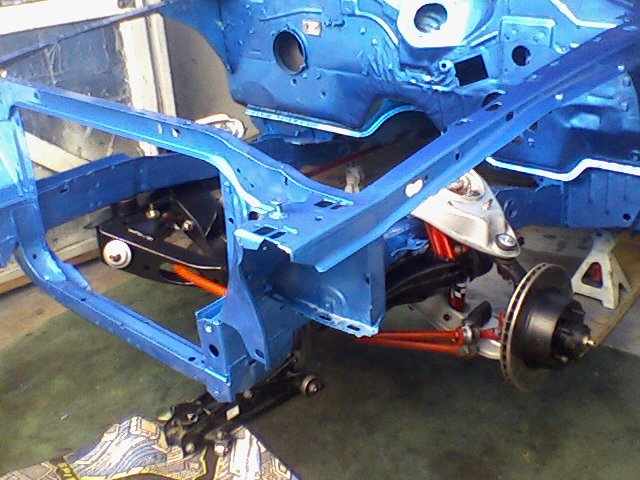

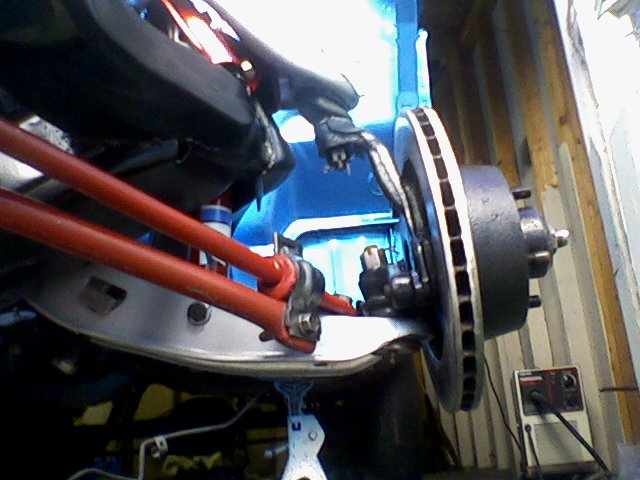

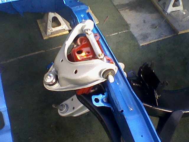

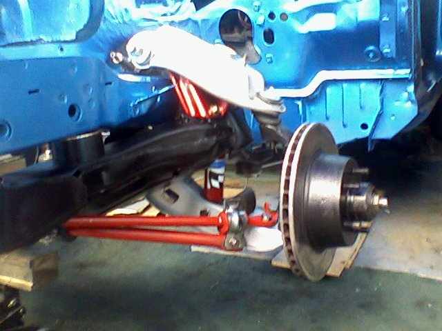

now for the front suspension....using all factory pieces, every replacable piece is new and not expensive...
i couldnt help but give these pieces a color contrast to show the detail of the components and to show it has been completely torn down and rebuilt. me likey..lol

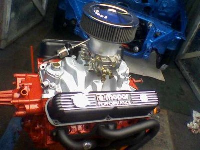

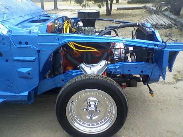

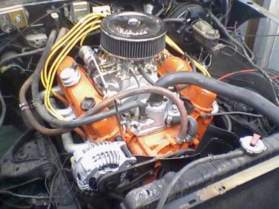

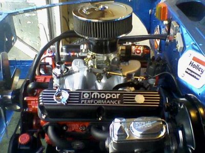

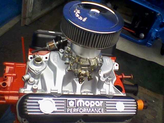

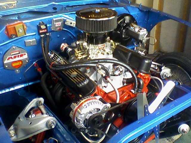

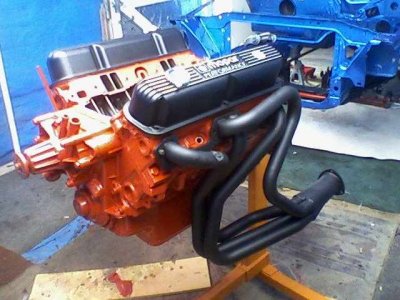

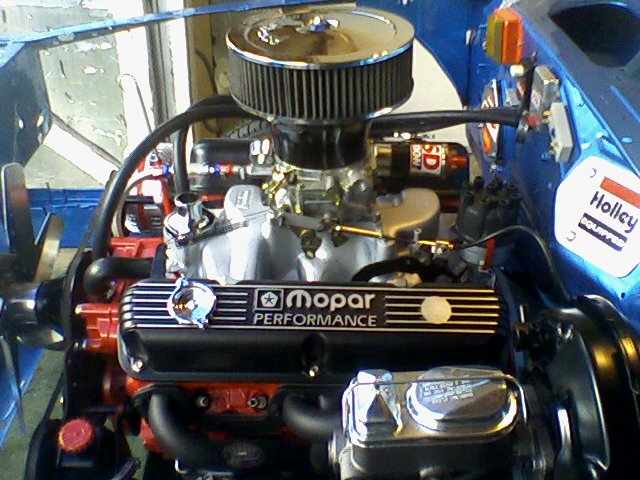

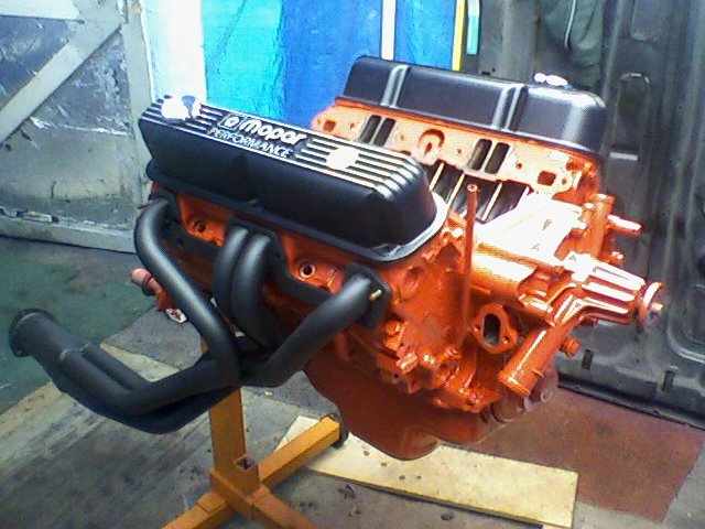

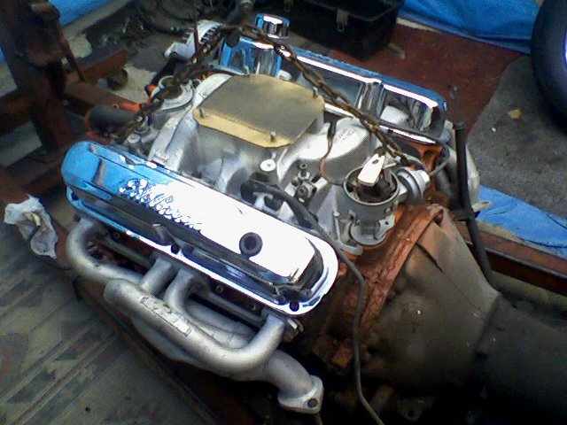

next on my list, was the engine.a tired 360. my first choice was a 440/727/8.75 combo. finding these around here are like hens teeth and very pricy. for now, rebuilding the 360 and keeping the 904/8.25 was the cheapest route.this car will get the big block combo,but later down the road. new bearing and gaskets,rings, cam/lifters and timing chain. the cam is a magnum 340 grind and a ten inch converter. im not being specific as this engine is not to perform but to be reliable for a driver ,until i get the 440.

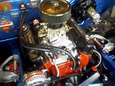

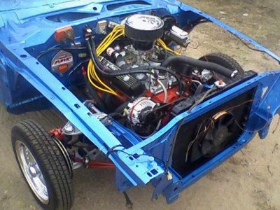

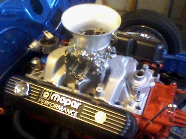

now it is reunited with the car..

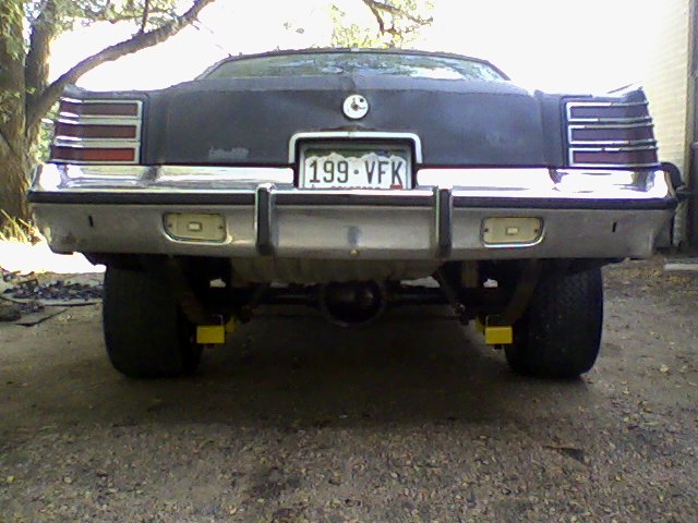

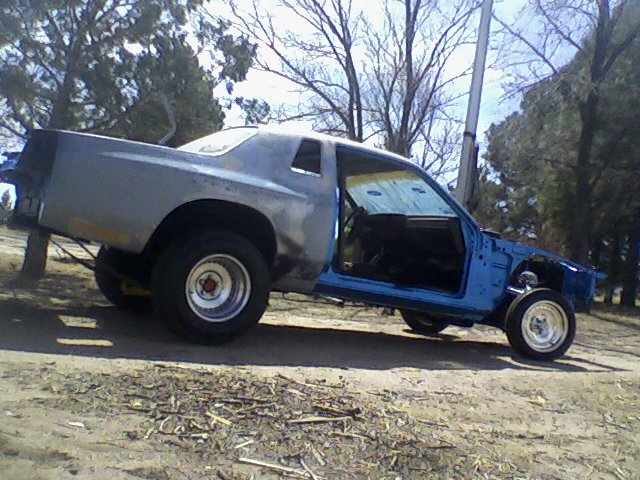

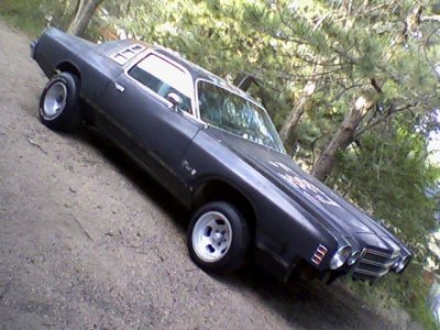

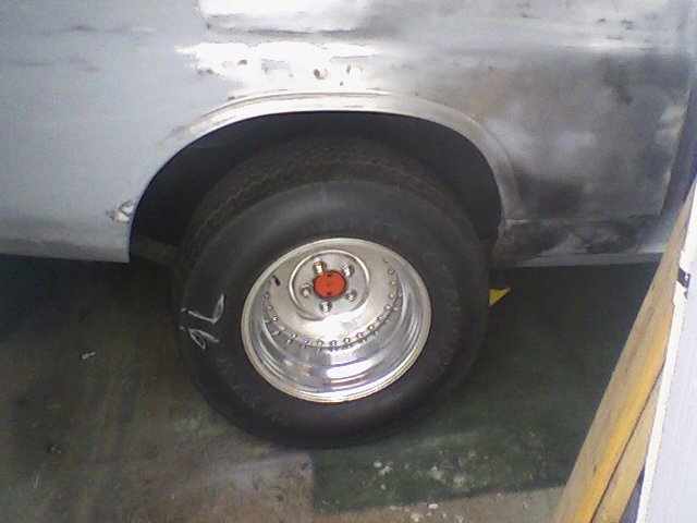

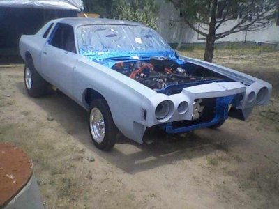

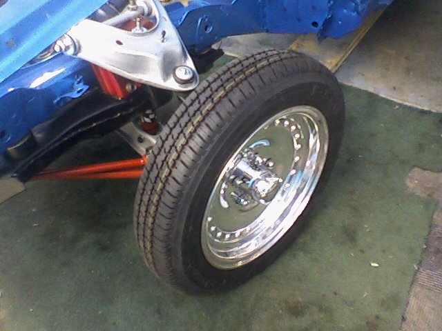

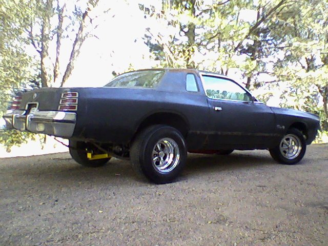

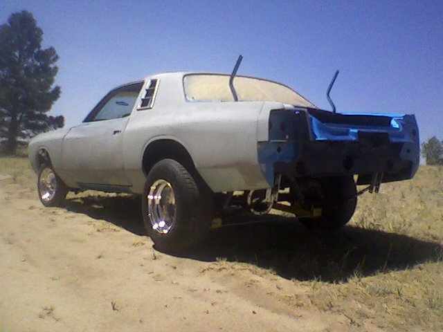

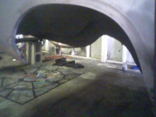

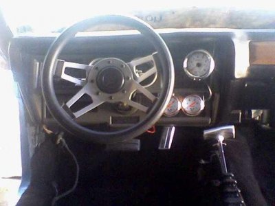

in keeping with the theme im looking at meats in the back,skinnies in the front.the rear wheel wells on these are huge and i want to fill them without tubbing it or dropping it to the ground. i have decisions,decisions.although the body is not painted yet, my patience with tire and wheel combos has worn out and so i broke down and planted some tires/rims on it.my rollers will go back on when i paint ,but i have to see what it is looking like. the previous owner had the rear leaf springs re-arched,and when i went to unbolt the rear shocks, the body jumped up 2 inches! scared the crap out of me,and i dont know how they got the shocks on in the first place. when i went to bolt on the leaf springs,they would not reach the original hangars no matter how far i lowered the body down on the springs. so ,until i get some real weight on the car ,i had to use some junky shackles to bolt them up. the shackles are only temporary, you will see what i mean...
back to the tires/wheels.back in the day, what were most running on their "hot rods?" most every thing had cragar s/s. i have options. i have a pair of ansen 15x10 aluminum slots and two matching 15x6s.i have two 15x10 polished centerline autodrags and two matching 15x4s. i have two 15x10 cragar s/s and two matching 15x6s. for tires,i have 275/60/15s and two old school N50x15 kelly supercharger meats.and two 255/70/15s. various other 195/60/15 and a pair of 145r15 bug tires.i dont have pics of the slots on the car but for now, i went with the 15x10 lines mounted on the n50s and the 15x4s on the skinnies.the 255/70/15 is a 29 1/2 tall tire with a 9 inch wide tread footprint .the 275 is a 28 inch tall tire with a 10 inch wide footprint while the n50 is a meat. 29 inches tall and a 12 inch footprint, all based on a 10 inch wide rim.

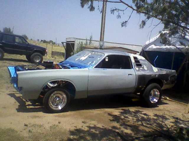

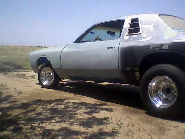

here it is out in the sun at various points in body work and rear tire sizes.excuse the shackles they are hideous but again only temporary.the finished product will not sit quite that high in the rear and i may ditch the skinnies for a wider tire in the front.
