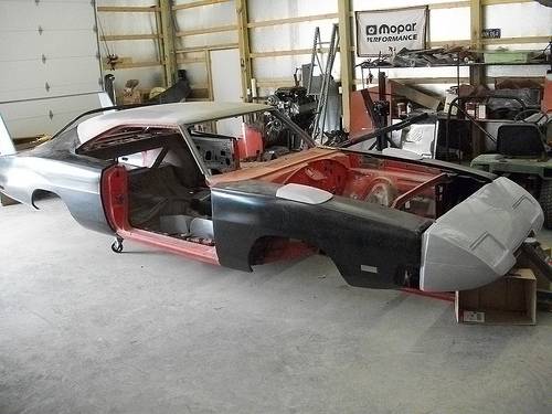

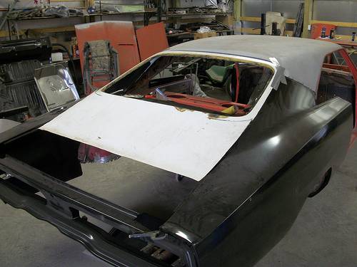

I don't have any pics of the harness let me post a couple of the bodywork done so far, Just made steel Z brackets off the fiberglass ones that came with the kit I am going to modify the 69 AMD fenders to work (add some metal here and remove some there! lol)

All in all when all is said and done I should have no more than $25,000 in the car (maybe less than that)
All said and done will be very cool. But one hell of an exercise in patients awaits!
Love the shop, wish I had one to work in! Every try to restore a Coronet out of a 1 car garage? Its like working on the refrigerator with it still in its box.

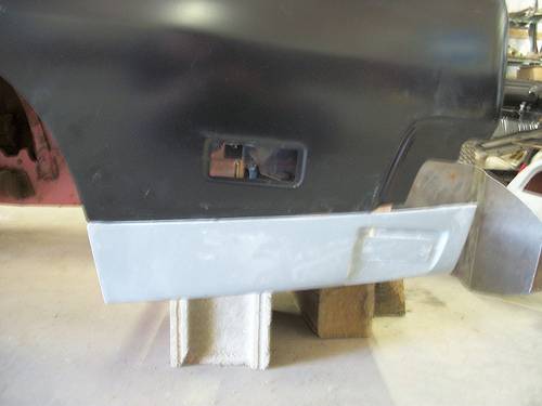

It's a Stinger kit it was $2500 for the complete kit shipped (Wing,Nosecone,headlight buckets, fender scoops, front spoiler, Z braces, headlight pivots, headlight doors, grille trim, wing washers, valance panel, latch tray) I am using a 78 Vega hatch for the rear window plug (picked the whole hatch up glass,trim and all for $150) I have a steel decklid closeout panel coming from Gene Gregory in Alhambra, IL (builds a LOT of nice steel Daytona/Superbird parts) I went ahead and made the steel Z braces off the ones that came in the kit because the glass ones were flimsy!

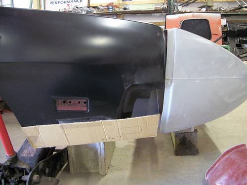

And I had been trying to find 70 fenders but I already had bought these 69 AMD ones when I was going to build a General Lee so I am going to modify these ones to work. I do have a 70 Charger hood coming so I can get the top and side of fender lined up perfect. Here is a couple pics of where I modified the lower fender tonight so the Daytona valance panel would bolt up, This car is going to be a serious driver with the 5.7 Hemi in it!! I want to take it on the Hot Rod power tour

Kit looks like it lines up well but some sheet metal work to do...have fun!
