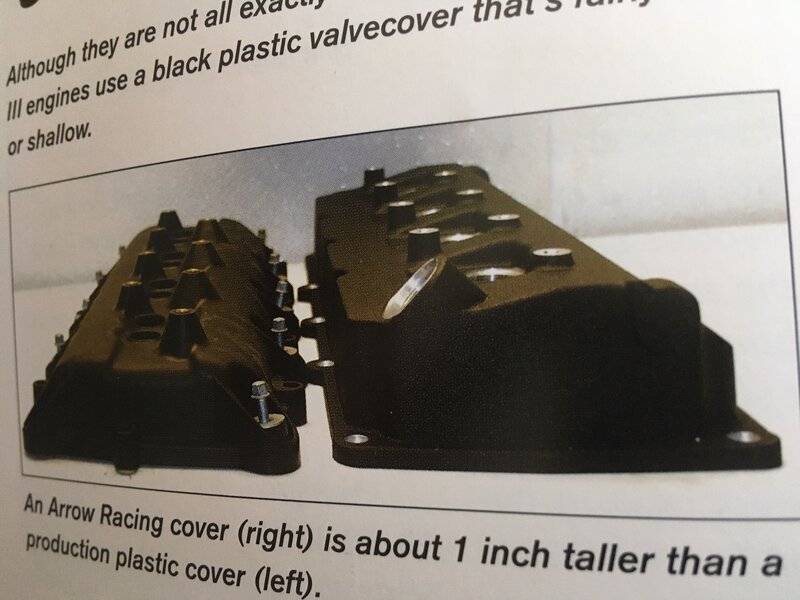

ARROW racing dose offer a cover with oil fill, but it is an inch taller

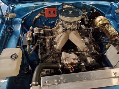

Thanks Bad B rad.. I'll check that out. Heres a couple quick pics. Gotta detail the engine and I hate the air cleaner.

That is a HUGE intake manifold!!!!

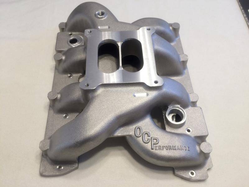

When I day dream about my 5.7 Hemi build I pick this duel plane, one:

I am sure yours makes more HP though!!!
Note the oil fill to the right side of intake.

Thanks. I gotta figure it out. It pulls real hard! The new Track Pack intakes have the oil fill port made into them like the one you have pictured. I was just trying to avoid swapping the intake. Thanks again for the info.
I was just showing how tall your intake was, I wasnt suggesting you change it.
This is valve covers by arrow racing
I think it is so much taller, because it has to route the oil to the filler port, and not threw the top of the head.
