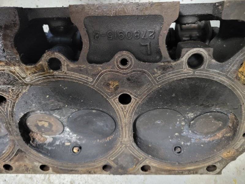

I recently pulled out the heads to check them for another project and was surprised to see they are 915 castings rather than the 516s that I was expecting. No HP stamping and 1.60" exhaust valves which I think would typically make them Chrysler/Imperial 440 heads.

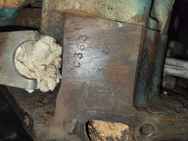

Good question. I don't remember if I ever checked before, just assumed, so I went out to the garage.
C383 with a March build date that goes with the April SPD of the car.

915 shared the port shape with the later 906
but with a closed combustion chamber. They certainly respond better to porting and bigger valves then the 516s. There is not much short side radius on the intakes on the 516 and the exhaust is pretty restrictive.

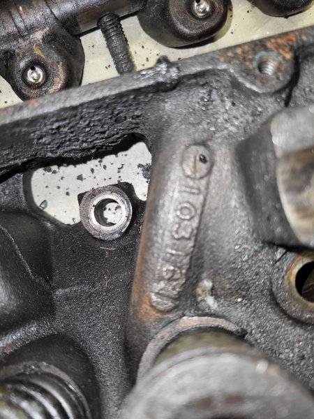

Find the casting dates. That could help make some sense. Burt valves were not uncommon back in the day. So someone could of swapped a pair of used heads or reman heads. Plus you know no history from the first 23 to 28 years of the cars life. May not even be the original engine.

Head casting dates - 10/31 & 12/05/66

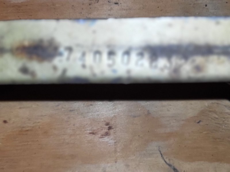

SPD - 4/05/67
Can't prove anything on a 67 with no VIN stampings, but all the dates make sense for an original engine and I've seen enough oddities to avoid saying 'never' when it comes to Mopar. Overall, provenance doesn't really matter though since the car is long gone and was a low option, nothing special car a anyway. Only makes for interesting discussion/debate.
