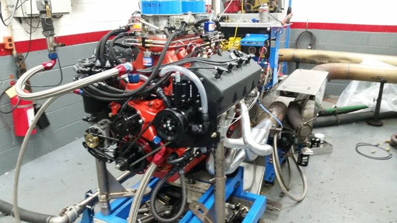

My 528 liked 33 degrees best while testing on dyno.
