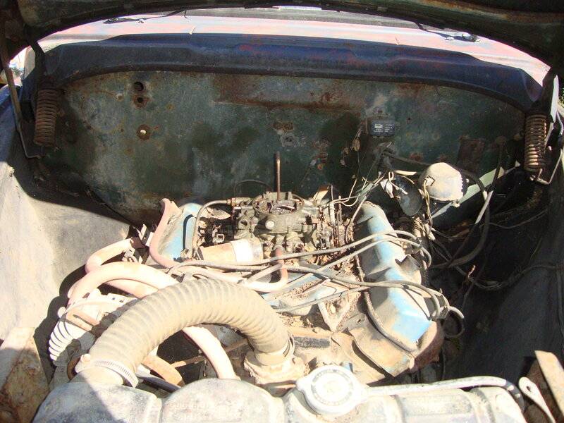

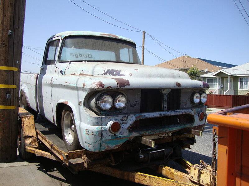

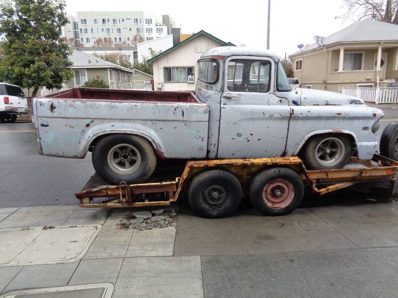

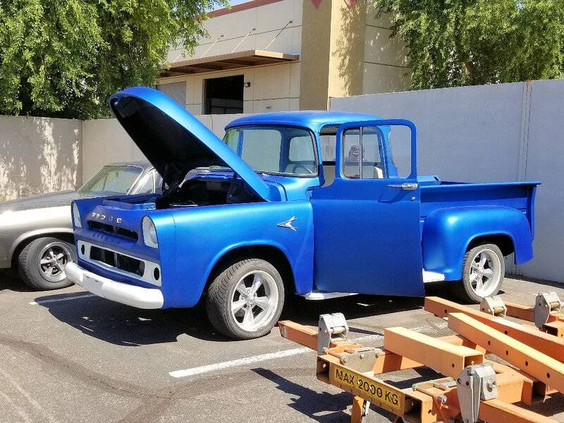

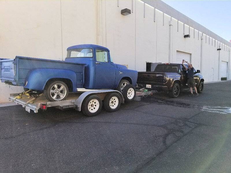

Daughter's fiance, retired USMC gunny, just bought this 57 Dodge in Arizona. Has a 318/727 transplant, runs, but needs lotsa attention. The 318 has shorty headers, HEI distributor, 4 barrel Holley and sounds like it might have a stepped up cam. We happened to pick it up on the hottest day of the year, about 115, then trailered it back to SOCAL. The pickup has a lot of potential.
Body panels are solid, floor needs some work, and bed needs new floor. Glass is good. Has most of the emblems. The suspension, rear end look original. More to follow.

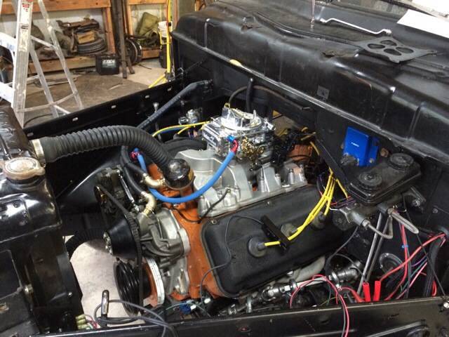

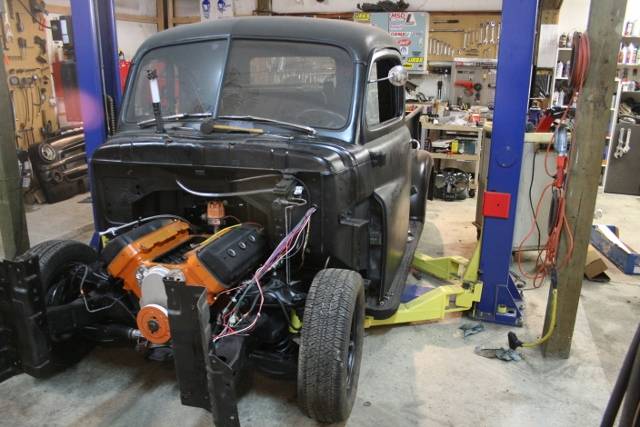

Got to love an old Dodge truck, here is mine; 52 B3B (1/2 ton) with a 56 Desoto Hemi, 88 Dakota front clip, E body 8 3/4 rear with 3.55s, SB 727, Fitech EFI.
Obviously that pic of the engine was before I put the EFI on. Also made different mirror mounts.
