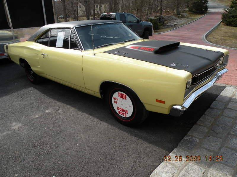

my pure stock A12 superbee goes high 11's on pump gas with 11.3:1
it does now 93 octane sunoco, goes 9.69-9.70 @139_mph

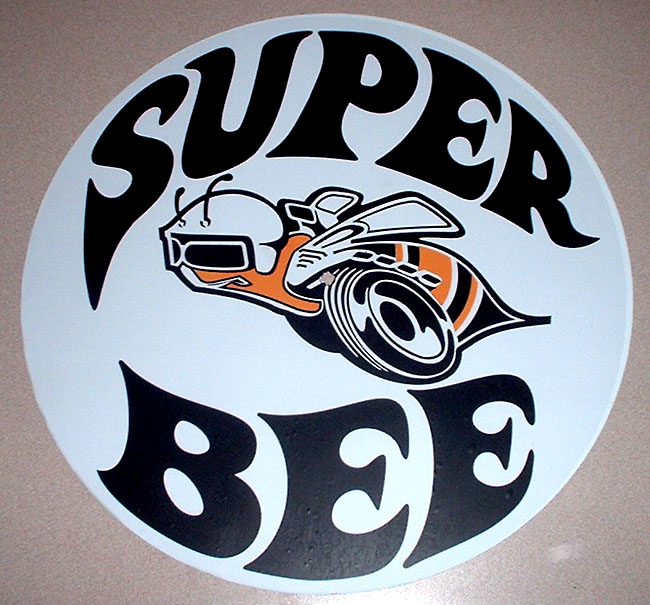

2. I repoed the stationary wheel discs you have on your car and created a much cooler graphic than the original "ride with the Dodge Boys" white hat picture. check it out.
If you want I can sell you a pair of the graphics that you could install on the reverse side of your discs and could switch back and forth as fast as you can unscrew the disc.
