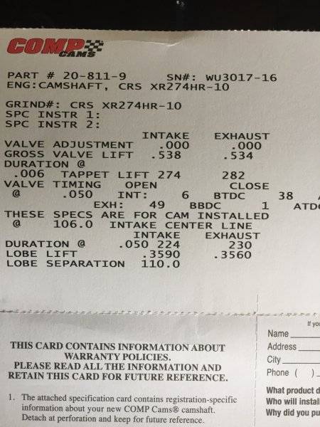

10-1 to 10.5-1 max. Although currently I have a 360 @ 11.3-1 using 93 with TF heads and TTI headers with a hyd roller cam that is small. 224@050 intake w/1.6 rockers.
Read it below;
The 9.8:1 would be a good ratio with those heads, camshaft, and pump gas.
Read it below;

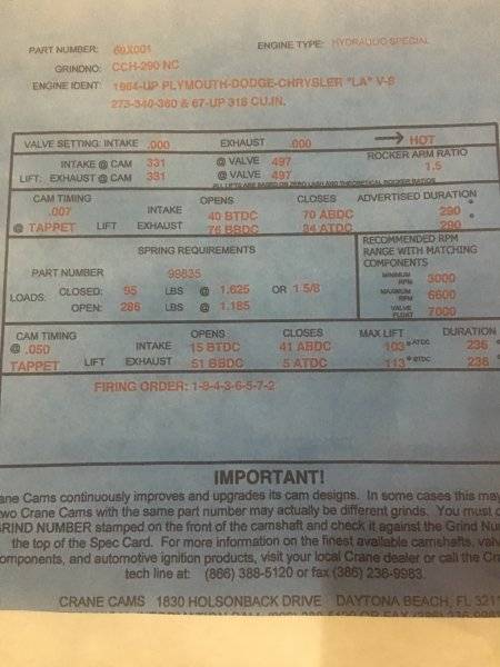

I have the Crane cams card from back in 70's somewhere, I think I remember it spelling out the 'overlap' between the intake & exhaust, but

Please do so show it and explain it for us all if you can.
It would be of great help I think for those here.
Here’s my small block Crane Hyd flat tappet cam card.
I know I didn't throw it away but it's been years since I remember seeing it so it may take me a while to dig it out. When I do I'll absolutely post it. My Roadrunner was the fastest street car in Griffin, Georgia back in the mid 70's. There were a couple of cars with big slicks, gutted interiors and open exhaust people would race for big money, I never raced those.
