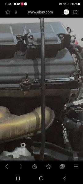

I installed a 2005-2006 Chrysler 300 6.1 hemi dipstick tube in my '11 Dodge Charger RT. After installing headers the stock 5.7 dipstick could no longer bolt to the header flange. This one bolts to the valve cover. Enclosed pic is not my engine. It illustrates the dipstick tube location. Valve cover bolts 6507007AA, dipstick tube 5037660AB, nuts, 61047115AA. Double check part numbers. I thought this might help anybody doing a swap in a b body with headers, but then again you all might know this.
