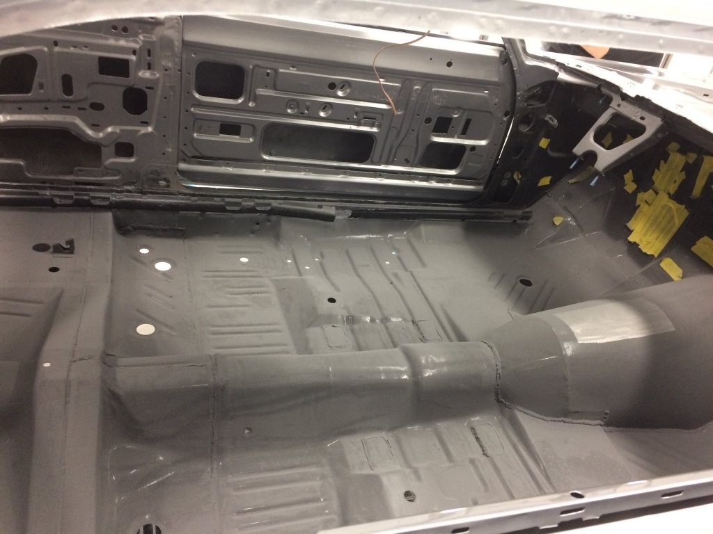

68.Mopar...I am going down that road as we speak to fit behind my 485 CI stroker in my 69 Coronet. I modified the hump, 1 1/2" taller and 5" wider and will have to modify tranny mount. I was a certified welder for eons so the sheetmetal work was easy for me. Go to TCI as they make a 4l80E that is a six speed and can handle about 700 ft#'s of TQ. TCI is now cutting off the bell housing on the one piece 4L80, incorporating a very stout ring with bolt holes and you purchase a Reid(I think) racing bell that just bolts to it and mates right up to a BB Chrysler. That way the spacing is correct, the starter is on the correct side for a Mopar and the odometer is electronic to match new gauges in your dash( no gears to match up). No it is not cheap but you get a stout 6 speed with a .75 OD that bolts right up and will give you the grunt for low gear fun and the over drive for comfortable gas mileage on the cross country runs.
