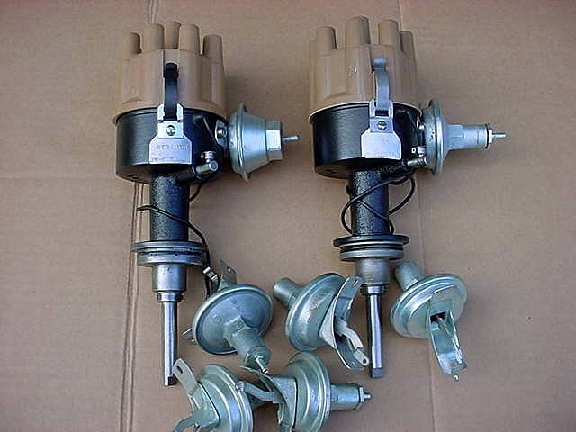

I got this from Bill Overcash...70 is on the left 69 on the right...The difference is just the vacuum advance...
BTW Frank does not restore the vacuum advance. So either find an NOS one or he just freshens it up. Bill O. And the link Big D above supplied they restore the advances too.
