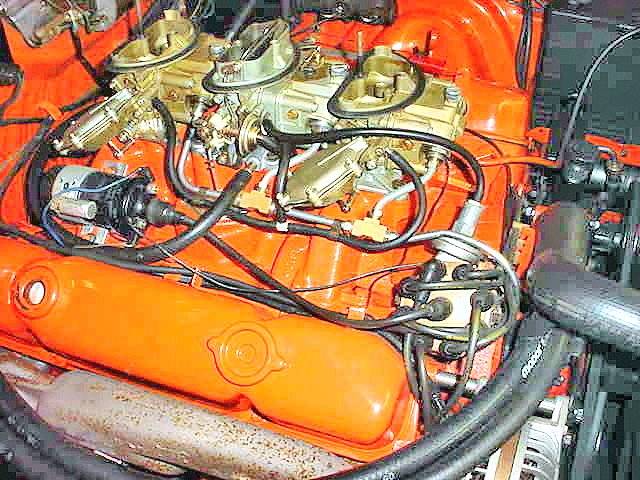

Getting ready to put the pack on the Bee is the coil wire longer then stock 440 and if so were do I find/get the coil wire?
Without measuring,it is at least a foot or longed.

It's longer than a four barrel coil wire because the Six Pack coil is mounted near the rear of the manifold.

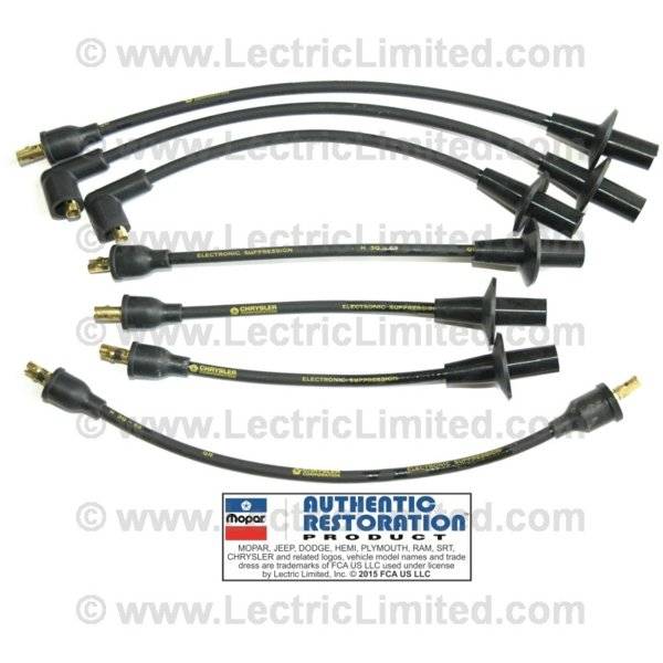

i got a hold of firecore and they put together a set that copies the original wires with the correct ends. also they are numbered.

The Firecore OE replacement wires for 6bbl cars now have 2 coil wires, the longer one for 6bbl and the shorter one for 4 bbl.
For anyone running points ignition and you purchase Lectric Limited date coded 383/440 wires, the spark plug wires come with both a short and long coil wire. I called them today to inquire about getting a longer date coded coil wire and was informed of this. Went home at lunch and sure enough there are 2 coil wires in bag.
