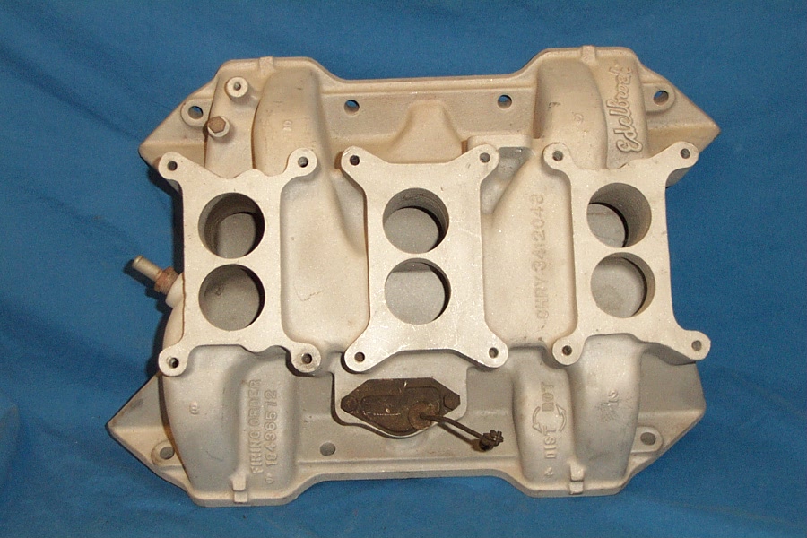

just buy the after market edelbrock its identical to the 69 factory except it says edelbrock on it and paint it up it looks and works great
The originals also say Edel. on them. The difference between the originals and the later repo is an additional identifing mark on the repo that can be ground off so it is undetectable which has kept the prices low on the originals because of this.

Here is the 69.5 Code M manifold.
