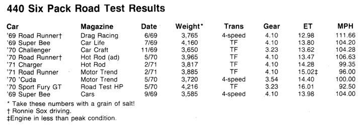

I cannot see why a Mopar stock 6 pack and manifold won't fit up to a '67, but all I ever see are 6 packs for '68 -'70 and '71. Am I just blind, or is there a problem to fit the 6 pack under the hood of a GTX or Satellite? I am running 915 heads, ported and polished with headers and 3" exhaust, so I would believe that "breathing" is not the problem. I currently have a Holley DP 850 on a Dominator manifold. Here is the type of articles I find. This is from an Allpar.com article. What am I missing here? One other thing...the '67 440 was actually made in July and could be designated for '68 models I guess.

The chart you provide refers to factory 6bbl cars, not just any that someone slapped one on later on -
and as you can see, there were no Mopar '68 factory 6bbl cars produced.
