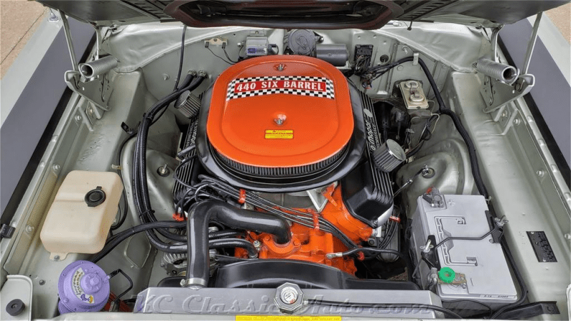

I’m working on a 1969 Road Runner. My 6 pack setup is a 1970 with the 1970 Charger style air cleaner. Looks like I’ll be in good shape to run it with the stock hood. Thanks guys.
Yep.....and you can add an air grabber set up to it like davek if you can collect the parts

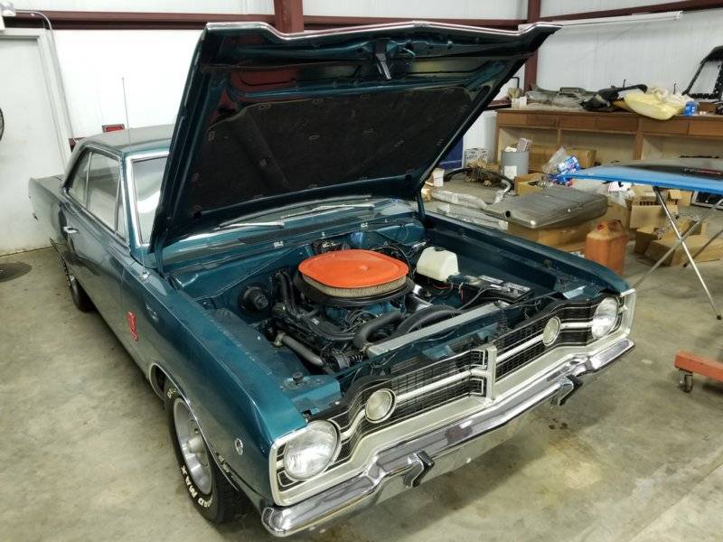

Yes, sixpack clears just fine under my 70' Charger hood. My car is a factory California car and does have the emissions and hood padding sound deadening package. The padding does rub the air cleaner slightly.
