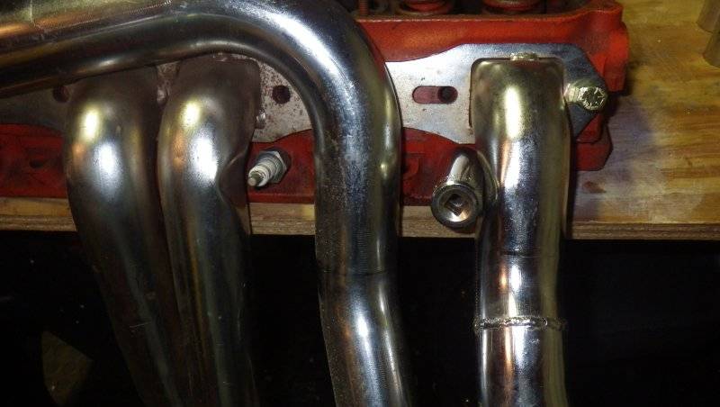

Hammer, pry bar,open end wrench. Probably need to massage the header tubes to make some clearance. Pictures?

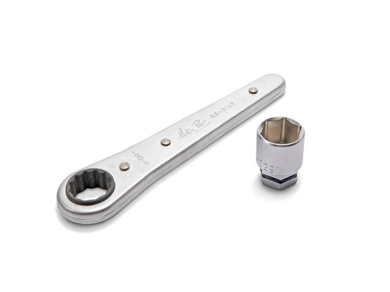

A few tricks I use for header cars:
1. Instead of a ratchet, use a hex-end wrench on the end of a spark plug socket.
2. Cut a wrench in half and use the stubby box end for tight spaces.

Sometimes ya' gota' do whatcha' gota' do.

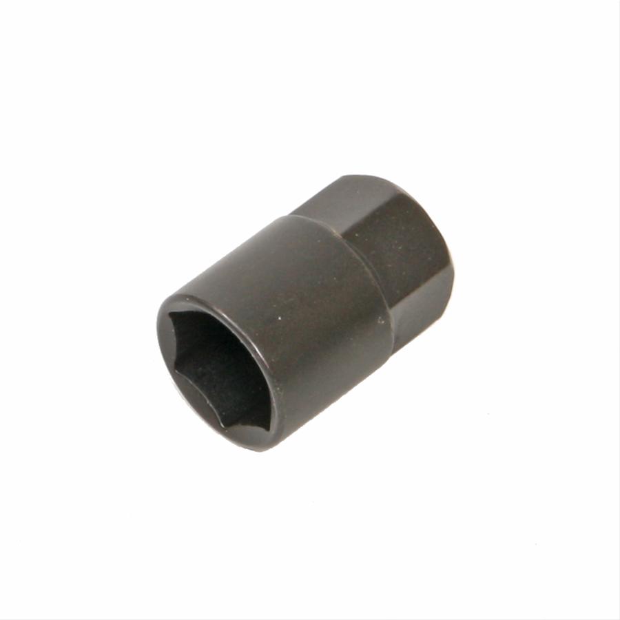

A fat six-point plug socket had issues fitting on a plug or two with these older TTi below.
Maybe try a thin wall 12 point to tighten and break it loose if you don't want to hammer header tubes for clearance.

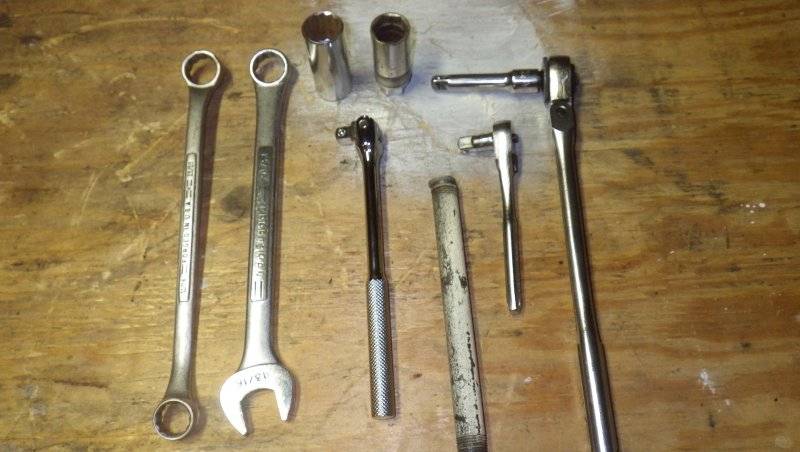

Some of the tools I use.........
