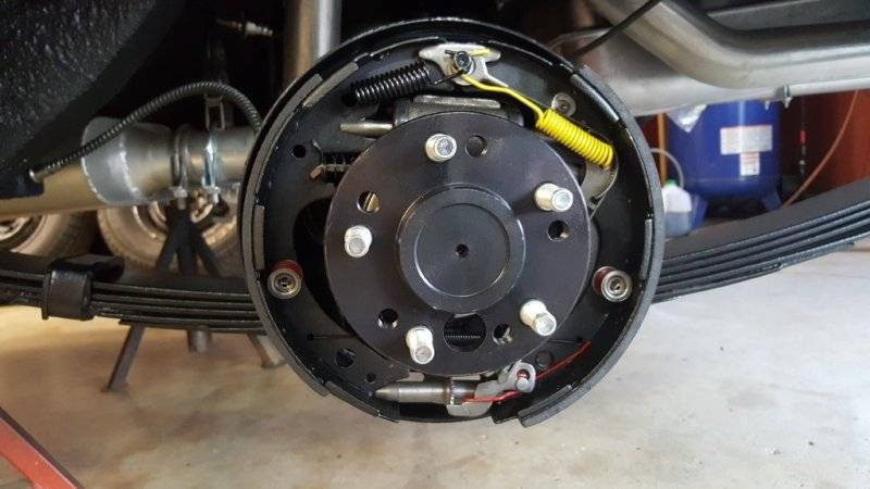

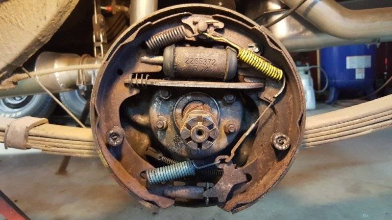

I did the replacement on my '62. Dr Diff has the axles ect. They are stronger than the original axles. I found my own brake parts. I believe Cass offers complete setups also. The '64 of course is wider than the '62 but you get the idea in my thread.

Another option...
Mopar Tapered Axle Brakes
I'm no skilled machinist but I converted my '62 to removable drums in my garage. Instructions here: Mopar Tapered Axle Brakes
I was able to use the drums that were already on the rear. Other than new studs the cost was ZERO.
