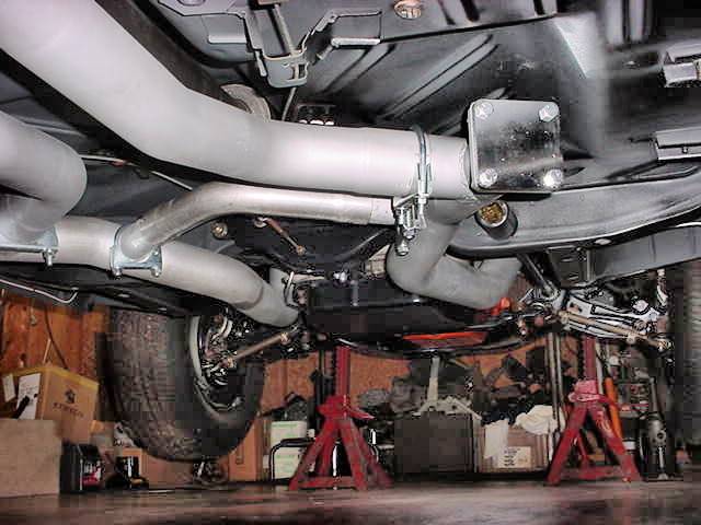

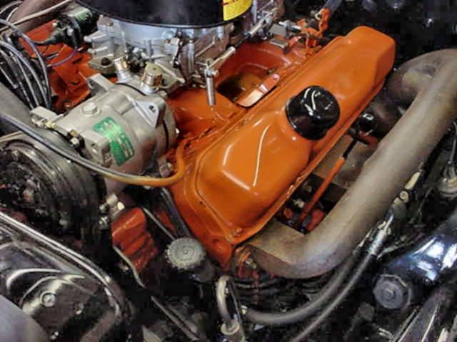

Everything works,at least 65 and earlier ![
ATTACH=full]675136[/ATTACH] Picture 620.jpg Picture 155.jpg
