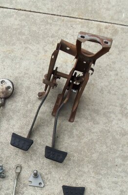

What year pedal assembly do you have? I know there is a 62/63 version and 64/65 version. The main upper bracket will curve down for the 62/63 and up for the 64/65.

I have pedals out of a 62. My understanding is the only difference between the 62 and 64/65 is the 62 has an additional bracket on top.
I have everything except the trans mount, fork, bellhousing, trans yoke, and driveshaft.
The clutch and flywheel are leftovers from another project and I just want to make sure I can use them.
