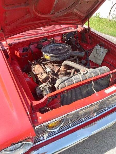

The car, 1962 Belvedere 2dr, 318poly has been sitting since around 1980 (i found a registration from '77 and believe it..
I just got the car home today, the motor is locked which i stressed about at work all day, got home and ran a bore scope down the cylinders, 4 cyls with surface rust, 2 look like it ran yesterday and 2 are around TDC, couldn't see much. Mixed up 50/50 ATF/Acetone and filled the cyls, VERY optimistic at this point :) Will give it a day or 2 and free it or fill em again. I was expecting scaly death but was happily surprised :)

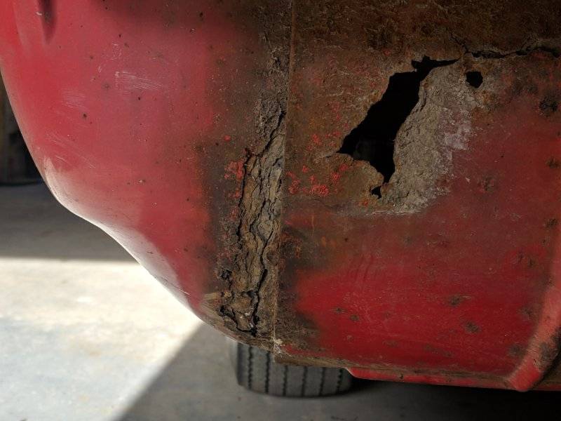

Any chance anyone makes patch panels for quarters? I am pretty sure i can hammer some since it's not compound but would rather go the easy way (and i'm 99% sure no one makes em) I HATE bodywork! just sayin...

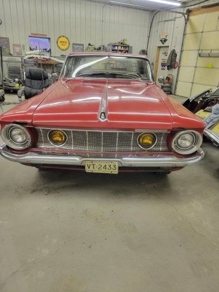

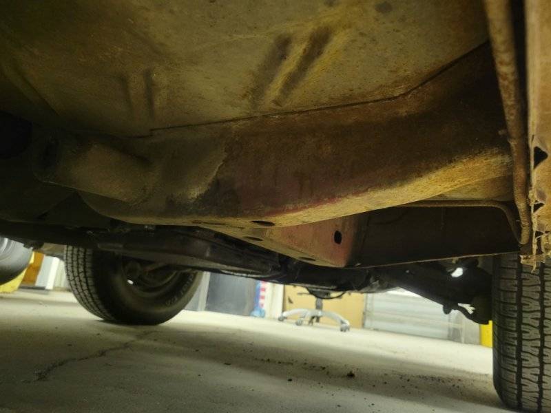

K.. heres some pics of the car, pretty much every panel needs some work, might try to find someone reasonable near detroit to handle the paint, not looking for show, just 1 color and shiny...
Also another question at the bottom
Car came with arizona fenders also... so that's good.. Seller took some seriously strategic pics or i prolly would have kept looking at other cars. Upside, the floor looks like day 1, same with engine bay (except at the top of a shock tower, some bubbling coming through, i think i can grind it out and just fill with weld, it's that small), trunk has 2 holes i will have to patch, but that's cake.

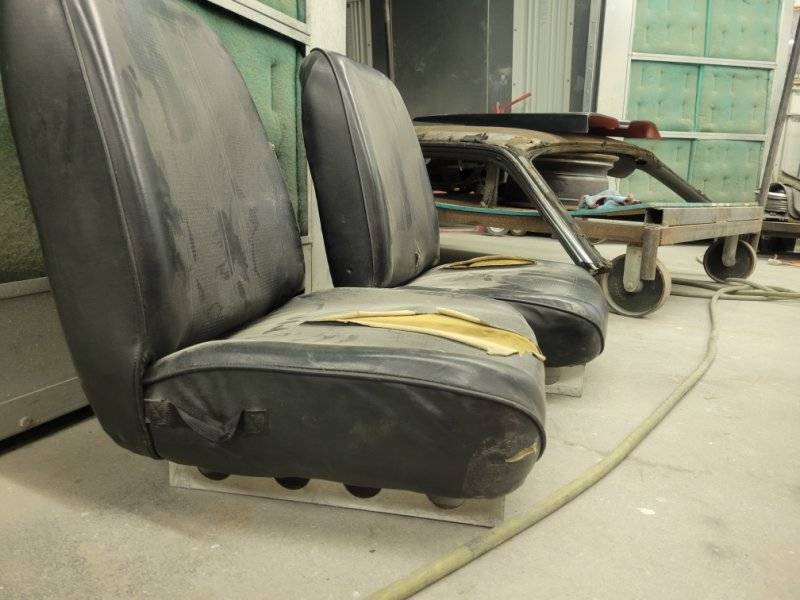

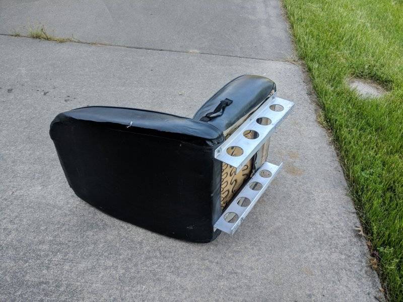

K.. so another couple of quick questions... Guy gave me with the car, a pair of a110 seats but i can't find a part # on the mounts and they honestly almost look homemade but i have never seen real ones before.. I will say though.. they are instanely light, i never knew..

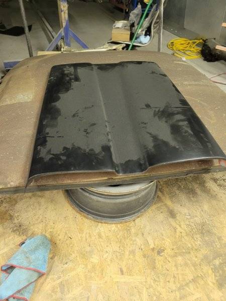

Also a hood scoop he said was an original and it seems much thicker than most aftermarket i have seen, but didn't take a good pic yet..

Go with a mini starter, it cranks faster. Seat brackets aren't factory, I know nothing about the seats.
No 62 ever got a factory hood scoop, not even the maxwedges. What you have there is an aftermarket 63/64 maxwedge scoop. A lot of them got put on 62s.

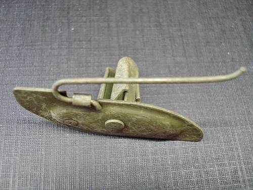

Go pick up a starter from your local NAPA and get the "lifetime warranty" version. I went through three of them before I got a good one. As far as the trim is concerned most of it should be held on with a few strategic PAL nuts on the ends and the rest are push in clips.
The hood scoop was available for the '63 so it may be "original" but not to '62. (what 33 IMP said)

Also, agree on the clips for trim. I had several missing, on my 62 savoy, but found a package of clips that could be modified to work perfectly, on a clip rack at my local Napa. Dirt cheap too! I can find a pic and part # if you need it.....

AHHH thank you!! it must be that one, i assume you can gently squeeze and push it out? I don't know why, but removing all this trim stresses me, all my old cars like challengers and such never had this much (cept my 64 polara which i never had to remove)

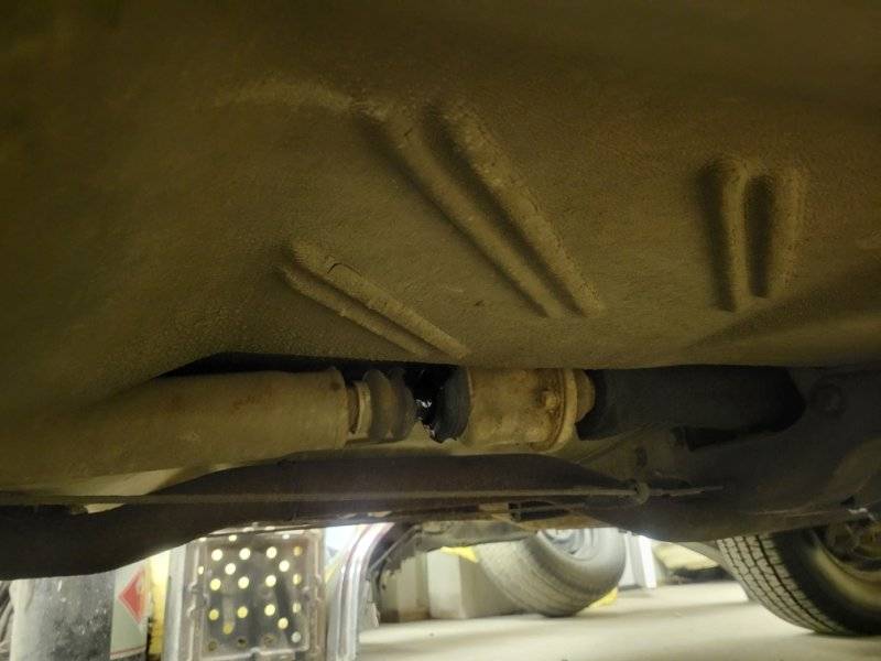

K, a little progress today, removed the gas tank.. inside was nasty, but sending unit wire/little boot were fine, the wiring in this car is still pretty flexible and in great shape luckily.

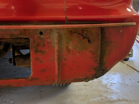

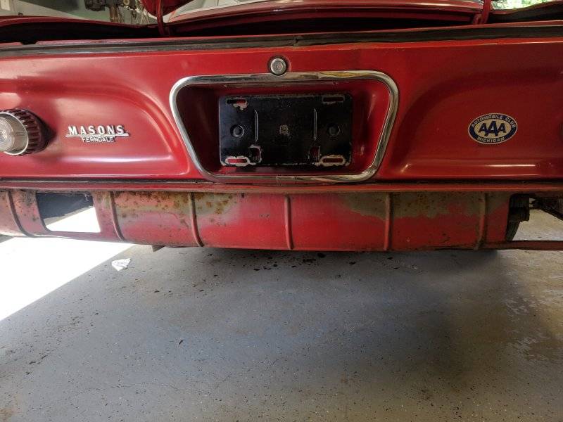

Also removed the rear bumper which took a hour and a half, a lot of deep creep and working the bolts back and forth, being a michigan car they weren't happy and i didn't want to take a chance of breaking a bolt and wasn't sure if the captive nut could break loose... Arms are tired :)
this car has a lot of surface rust spots coming through the paint, i wish i could stop it without grind/destroying the paint.. it's just gonna be a driver but i want to try to stop any rust i can.
in the other pics it's the corners, obviously i need to cut out the bad stuff and replace with metal, but not sure how well i will be able to get to the inside of those corners, i had no idea they welded them on like this. I have a lot of spots where seams meet that have some bubbling in the seam, All i can think to do on spots like that is pick out all the bad stuff and por15 or use some rust converter..

Last thing.. While the floors before the rear end are perfect, from the start of the wheel wells back are very surface rusty, nothing bad though.. so i'm 99% sure i will be pulling the rear end since it's only a few bolts and wire wheel/por 15.. or some type of rust convertor then painting the floor black just to protect it and make it look decent.

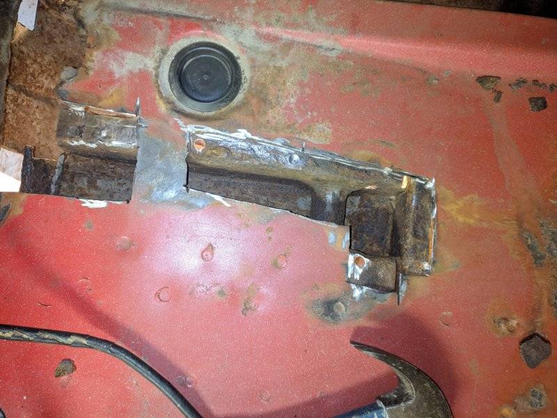

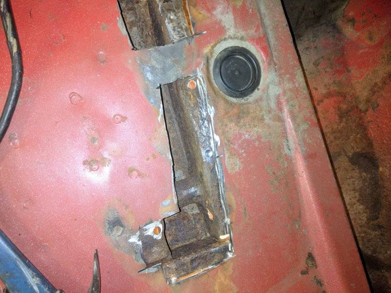

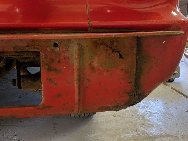

So.. started cutting out rust in the lower valence, i hate that it's welded on, i'm trying to form a plan of attack to repair the spot where the trunk extension/quarter/valence all meet as it's really hard to get to.
These pics are of the spots i have cut out of the drivers side trunk so far, going to clean the shackle box, reinforce it, rust convert then paint.
P.S. I believe there is supposed to be a C shaped tube going sideways from the back of the shackle box to where the trunk meets the extension (under the car) my drivers side on doesn't exist at all. If someone could please snap a clean pic of that spot (or let me know if there are drawings of things like this somewhere) i would be grateful, thanks much :)
