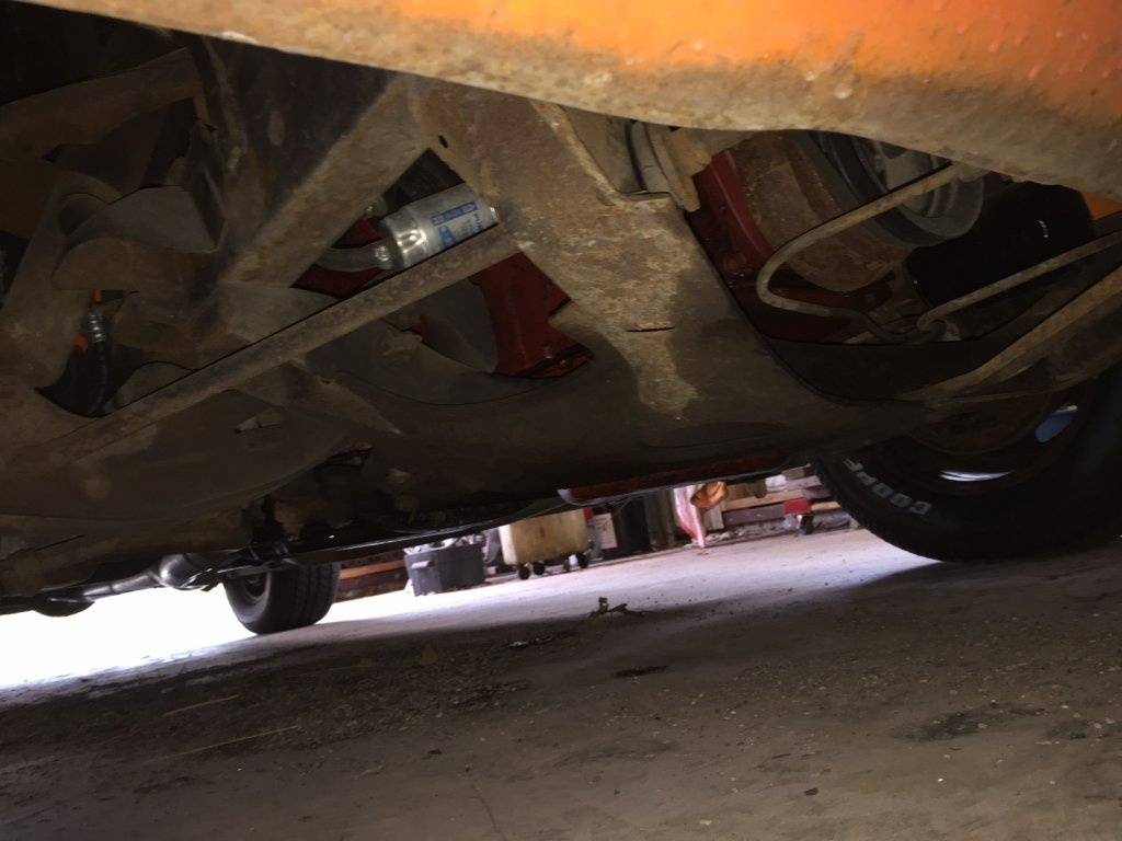

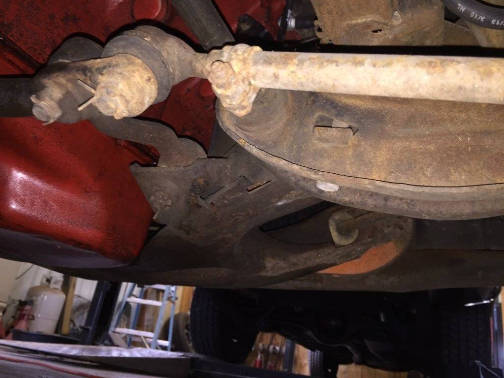

Guy wants to trade it for my 65 Coronet.....what do you all think of the undercarriage photos, any visible problems (besides the drink can, or is it there for a reason?) rust, oily looking crossmember, gas tank straps?

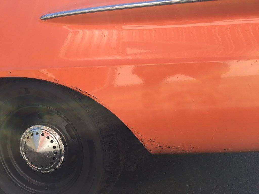

Big thing with wagons is rusty spare tire well. Ask for photos of that and outer wheel well lips of the rear quarters.Any idea where it was from ?
There is rust in all the areas you mention. Car used to be a New Mexico Border Patrol vehicle. Stock 440, 727, 8 3/4 radio /heater delete. Original V8 model built in C
A.

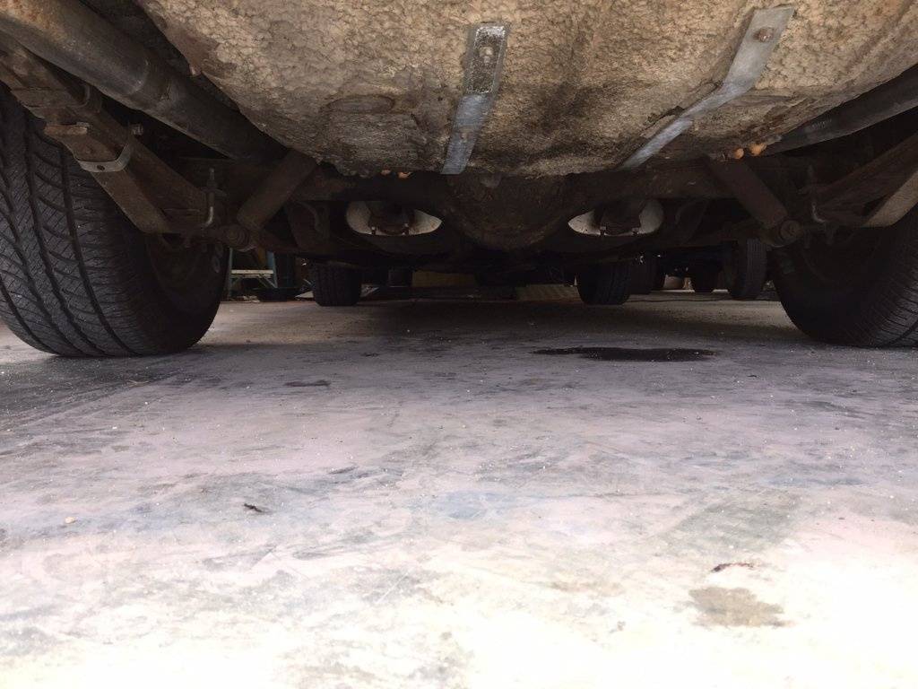

The gas tank sits upright in the drivers 1/4 panel. I'm not sure why those straps under the spare well is for?
Depends on if and how bad you want a wagon! Looks like it going to be needing some serious metal work, besides the obvious spots!
Probably to keep the spare from falling through the rusted out tire well...

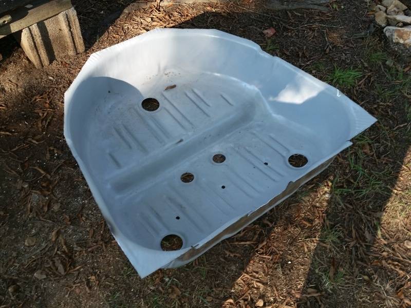

If you need a spare tire well . . . look at what I cut out of my Belvedere . . . it's sitting at the house collecting dust . . .
sm_removetirewell05-jpg.358873
That is . . . if a B-body tire well will fit in the Dart Wagon . . .
Can I ask why you cut it out? Just curious.
Sure thing . . .
With my rear narrowed 3" each side, and the springs relocated, I'm going to need someplace to run my exhaust - so out it came . . .
Plus the end result in the trunk looks pretty cool too . . .
sm_removetirewell16-jpg.360389
Is that the spare tire well floor pan for a station wagon ? Just asking never seen one before.
