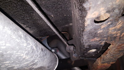

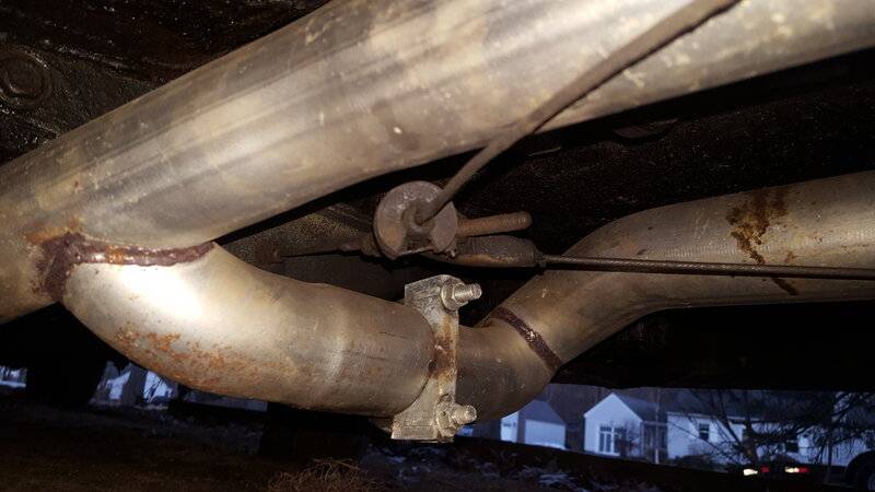

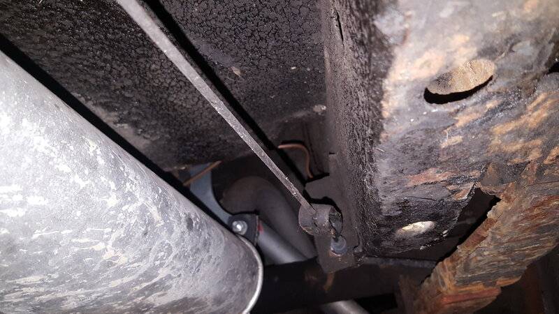

I need the 2 long cables that run from the front bracket to the 2 rear cables.
Not sure if 62-65 are the same.
I think it may be 1 long cable, looped through the front U-bracket ? I'll try to get a look at one today...
'62 Dodge and Plymouth, '63, '64, '65 Plymouth B-bodies are all 116" wheelbase and take the same long e-brake cable. 1963 and 1964 Dodge B-bodies are 119" wheel base and take a correspondingly longer cable. As some else has said, this is a one piece cable that loops through the adjuster bracket. Try Joe Suchy or Jim Kramer for this.

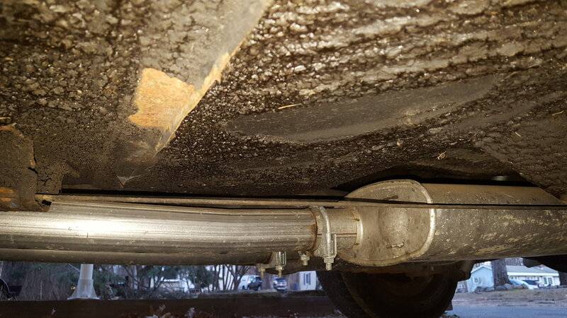

The pics I took are of my 64 Plymouth wagon e-brake, which has always worked without issue, never had it apart.

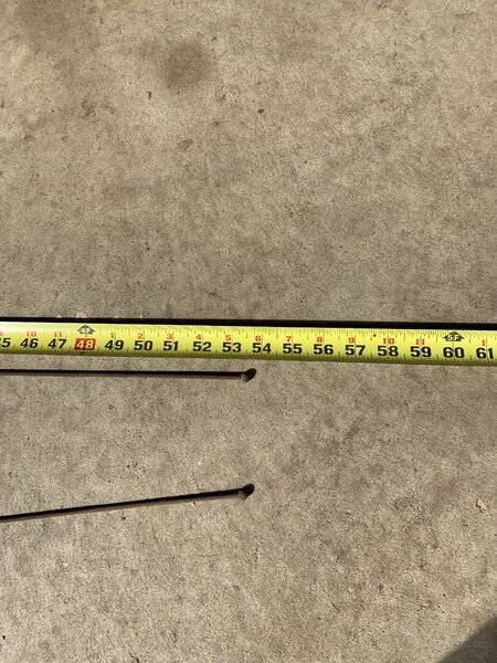

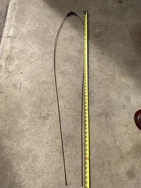

There are ones listed on ebay and summit that allegedly fit a 62 Dart, only one that I found, so far, lists the length, 56.88".
All are $24-$40 shipped.
Between $90 and hoping the length is correct, I think I'll try door #3, the local hardware or big box store, cut to length a 59" piece of cable and grab a few crimp on ends.
