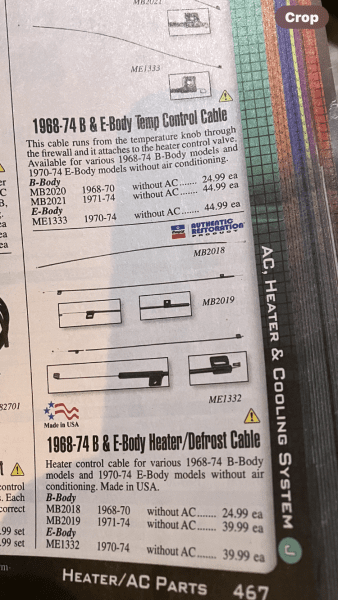

Looking For The 2 Cables That Attach From The Heater Control Panel To The Heater Box on a Non A/C 69 Superbee.
I Noticed Classic Industries List 2 Different Ones
I Might Have a Few In My Parts Bin, Would The Cables Be The Same Length? Thanks
No. That's why there are two different part numbers. Plus they attach different.
The Temp Cable Says It Runs Through The Firewall, Which My Car Does Not
Would I Get 2 Of The Defrost/Heat cables?
No you would get what they show. Two different cables. The narrative is wrong.
