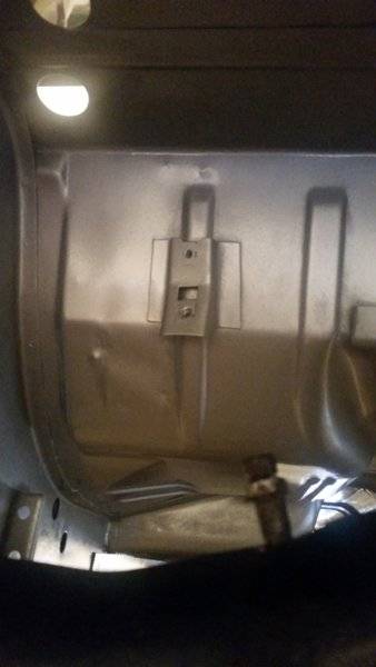

All my brake line were striped by my uncle before i got the car. I believe i am missing some sort of bracket but dont know. Can anyone post a picture of where the rubber line that comes out off the axel block on one end then connects to the hard line going forward. I am guessing there should be some sort of bracket where those to lines connect. I am posting a picture of the spot i think it should bolt up to. It is a shot from behind the axel looking forward it also shows the axel vent bolt for a frame of reference. Am i correct and can anyone post a picture. I have lots of parts and my actually have it if i knew what i was
what i was looking for or will fabricate something.
All my brake line were striped by my uncle before i got the car. I believe i am missing some sort of bracket but dont know. Can anyone post a picture of where the rubber line that comes out off the axel block on one end then connects to the hard line going forward. I am guessing there should be some sort of bracket where those to lines connect. I am posting a picture of the spot i think it should bolt up to. It is a shot from behind the axel looking forward it also shows the axel vent bolt for a frame of reference. Am i correct and can anyone post a picture. I have lots of parts and my actually have it if i knew what i was View attachment 571532 what i was looking for or will fabricate something.

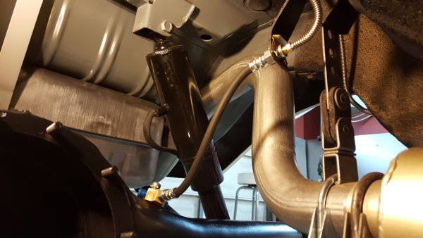

Hope this helps !

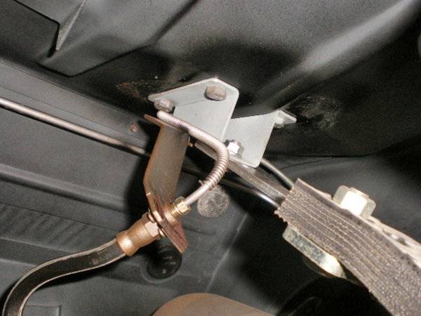

i dont know of any place that has a place for a 4 bolt bracket something is different
The four bolt bracket is to match the original that was originally welded to the floor pan.
I was thinking just that. I wonder if they were known to pop off. Like I stated, there's one exactly like it on my passenger side. Has a plate on the inside of the car with sealer in between.

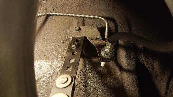

Car was originally a /6,made them out stainless and replaced both when I installed the 3" TTI system.

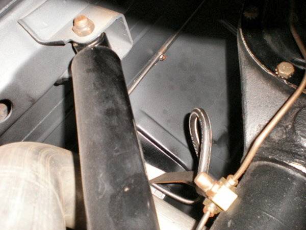

FYI, when you install the brake hose, do it with the rear housing all the way down at full extension. My new hose was just a tick short and I had to do some tweaking on the bracket so there wasn't any strain on the hose.
