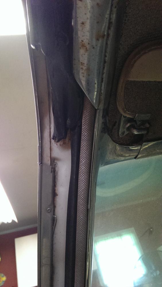

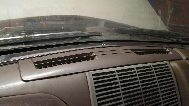

I have had this 62 Polara 500 apart for 7 years total resto and now putting back together.
The windshield is back in and replacing the interior windshield bottom trim piece, it doesn't look like it fits right. I think there were some rubber spacer under it but don't know where. Any one know or have a manual picture?
I have service manual and parts manual they don't show anything

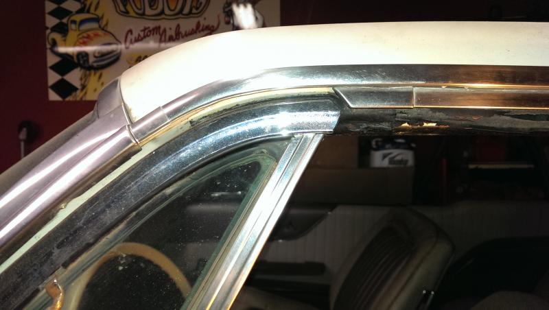

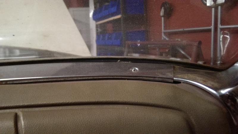

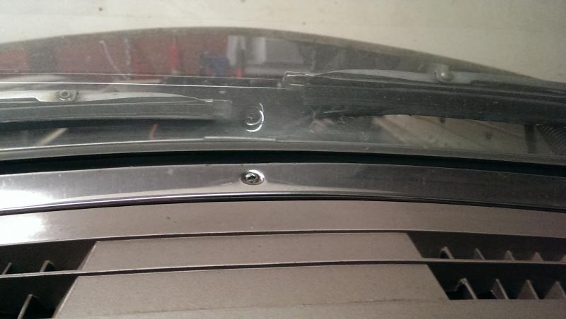

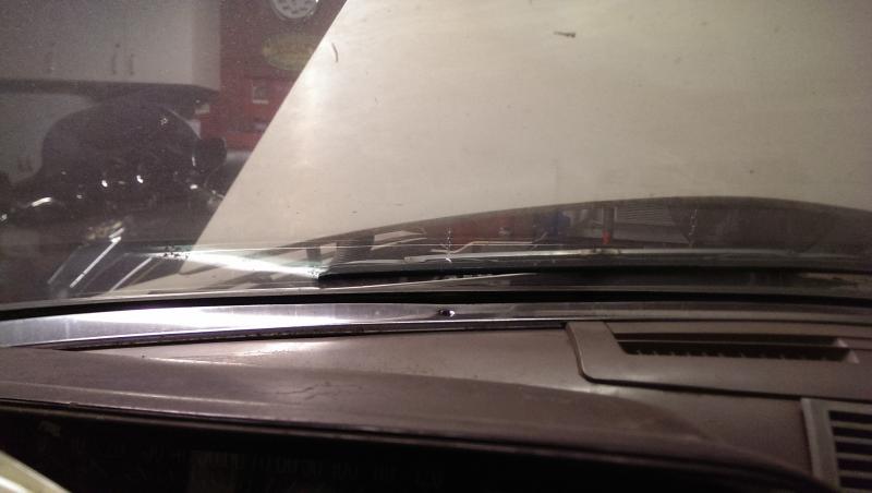

These pics are from my '62 P,500. The trim has never been removed. If you notice on the last pic the trim starts off kind of upright then flattens out in the middle. Looks kind of strange but that's the way it is. Hope this helps...

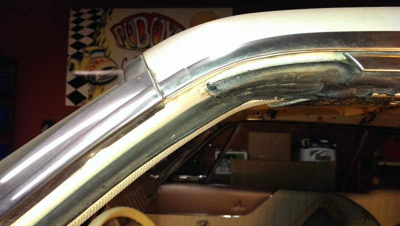

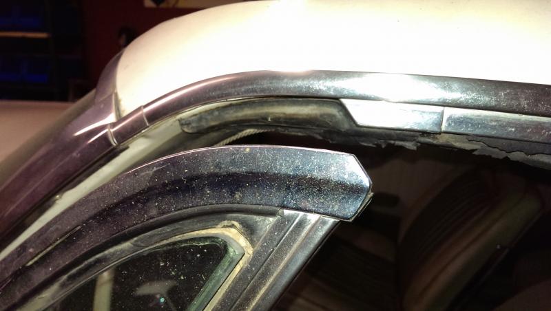

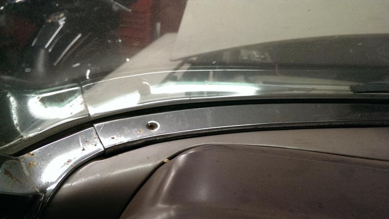

That's what mine looks like kinda weird, can you take a picture were vent window post stops on roof rail.
I was wanting a pic so I could see were the roof rail seal stops.
I almost didn't see your request. Pm me next time...
