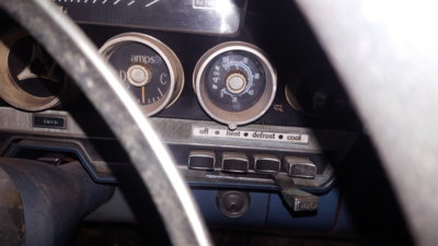

I have a replacement bezel for the dash that is in much better shape than original.
See picture.
If I want to replace just the bezel does the entire cluster need to come out too?
Also, how do the nobs for the lights and wipers come off? I gently pulled to see if they would slide but no luck. Second pic is of existing dash.
On my 66 you must reach up under the dash to the headlight switch and press a small tab, then pull out the knob AND stem.
You have to remove it. Not that hard. Disconnect your battery. You have to remove the knob from the heater control (small allen screw under the knob). Then remove the small screws that hold the face plate on. Then you can remove the screws holding the cluster and carefully pull it out. You can reach the speedometer cable doing this or reach up under the dash and remove it first.
Wires are fairly easy to get to after unfolding the metal retaining straps that hold the harness. Unplug the dash lights, remove nuts in the amp guage. Unplug headlight switch, remove wiper switch by removing the knob (small allen screw) then the nut. Mark where wires go with a piece of masking tape and take some good pictures.
Once out you'll remove headlight switch and all the screws on the back to separate both pieces.
I have lots of pics of this. Just pm me for any you need.
I
To remove the headlight switch (you can do this after you have the whole cluster out) first turn the switch knob all the way to the left (interior light position) then push on the button (red arrow) and pull the "shaft" out of the switch. Then you have to loosen the "nut", which has two slots in the end. Normally a flat blade screwdriver will turn it. Then the switch comes out.
On the wiper switch, I just remove the knob (small allen screw under the knob) and remove the retaining nut. Leave the switch in the car.
I see you have a clock. Before seperating the two halfs you'll have to remove the small hollow nut in the center of the knob. (Small screwdriver)
Then you'll have to drill your replacement bensil for the knob the same size hole as your original.

Yes the clock was an option. Funny thing about my '62 is that they ordered it with no power anything, no radio but they had to have the clock.
I lucked out on fleabay and got the set of NOS Autometer guages, from 1970. It came with an AMP guage, with the warning about useing it. Come to find out, Autometer still makes these, so I bought a volt meter to replace it. I like them.

Was the clock an option on these cars?
On cars not equipped with a clock, the blockoff for the clock can easily be adapted to mount a 2 1/16" oil pressure gauge. The plastic blockoff is shaped somewhat like a cup, with the bottom of the cup removed you can slide the body of a 2 1/16" gauge into it and make use of that dead hole.
