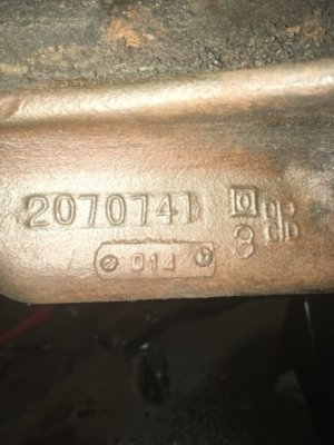

Rear End: I believe it is a 8 3/4 rear end, 741 #2070741

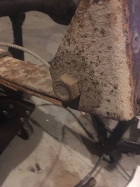

#2: Leaf Spring Bolts - I was unable to remove the leaf spring bolts. Does anyone have any suggestions for removing these bolts? Would it be OK to get
a cutting wheel and replace the bolts all together? I am afraid to cut the bolts and damage the leaf springs. (If the leaf springs have to be replaced this is a non issue)
I can get the bolts for about $20 online. Should I cut the bolts off or try to find a different way of removing them?

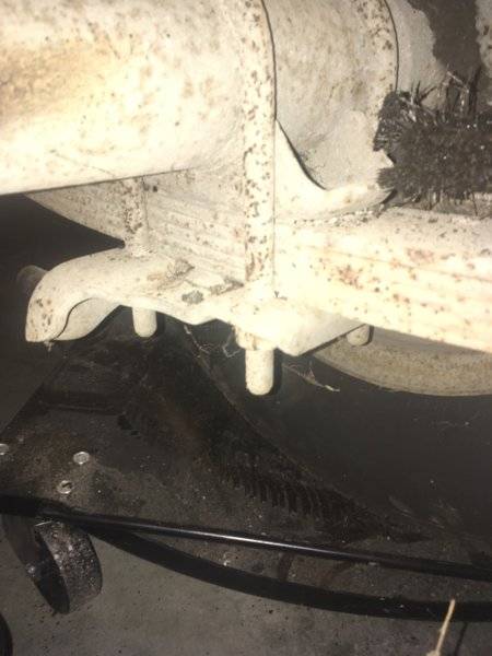

#4: Leaf Spring Mounting Plate Ubolts - The UBolts on the leaf spring mounting plate are not budging. I think I broke a ratchet trying to get one off. I
would like to go get a cutting wheel and take off the UBolts. I am not sure if they can be replaced easily. Could I replace these bolts with Ubolts from the hardware stor?
Or do these need to be specialized bolts specifically for the mount?

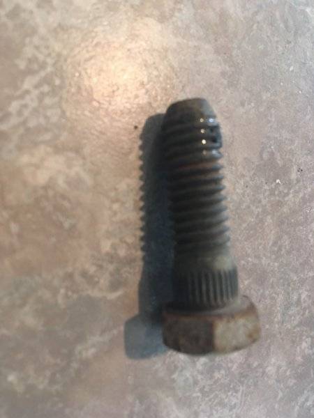

#5: Leaf Spring Mounting Plate Shock Absorber Post - I snapped this bolt off when trying to remove the shock absorbers. I found a stud replacement (thanks to you guys!!! BIG HELP!!!)
that I will be ordering and replacing. My question is on the shock absorbers, is there a specific one to replace them with? Is there a reason to upgrade, will it make a difference.

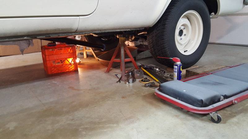

#1 Hangers,Clean 'um up and paint. Reuse
#2 Best bet cut off the U bolts. They don't cost much
#3 Check out ESPO for new springs,Prices are good call 'um tell them what you have and what they recomend
#4 Replace 'um Check with the local Auto Parts or order them from ESPO. May be easier to get everything from one place.
#5 Good 'ol Monroe Shocks are what I use. Sounds like this is a cool driver,and you won't need much. Unless you like to spend money and the sky is the limit.
#6 I used GOOD oven cleaner, the dollar store stuff is a waste of time.Paint away !
#7 Replace the pinion seal, check the axle seals. If they aren"t leaking leave them alone. the pre 1965 8 3/4 with the nut on the axle end can be a real bear.
Have fun and there are plenty of people on this site willing to help. You went about asking the questions in a excellent way .
Use a cutting wheel to get most of the way through the bolts, so you dont risk cutting into the springs, then give 'em a twist with the wrench and they'll snap right off.

Cut the u-bolts at the top. One cut right in the center and the bolts will come right out. Cutting wheel or a hacksaw with a good blade. U-bolts cut quite easily.

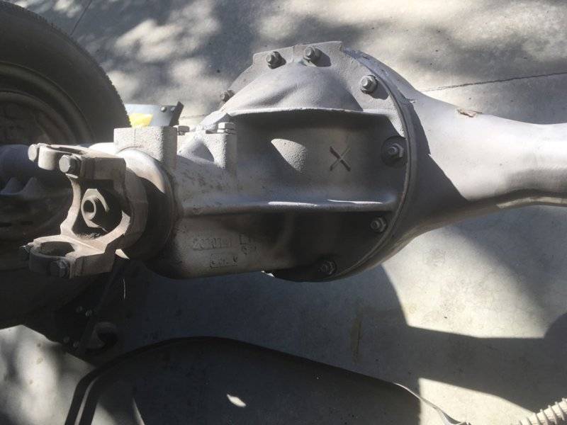

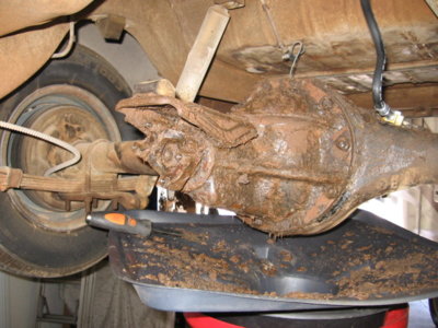

DP62, Just a few photos for you from a really crusty 63 8 3/4.
Using oven cleaner,Scrape as much of the heavy stuff off before spraying.

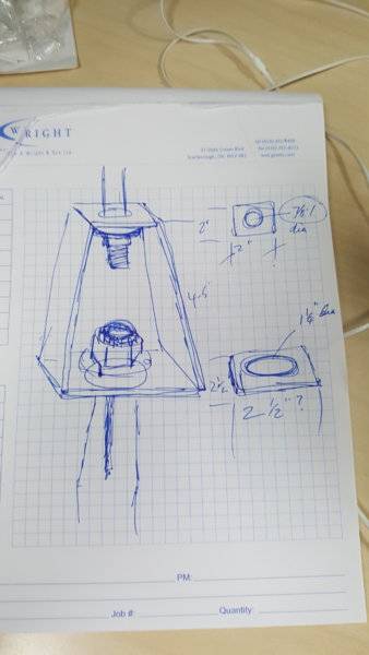

I bought a 63 rear with the intention of rebuilding and installing in my 64 because it is narrower than the 70 rear I'm currently using.

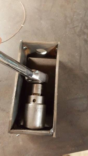

Because it is out of the car, the axles were a pain to remove. I made this simple box to use with my slide hammer and made it large enough to use a ratchet for the axle nut. It worked well but the axles were stuck in there pretty good. Have to secure the housing from moving and took quite a few wraps. In the end I had to heat up the housing around the retainer to free one of the sides.

I made the exact same piece two years ago! :thumbsup:

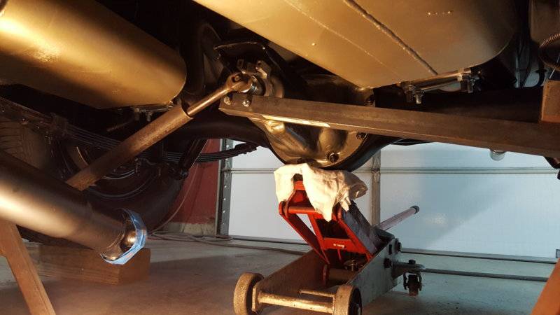

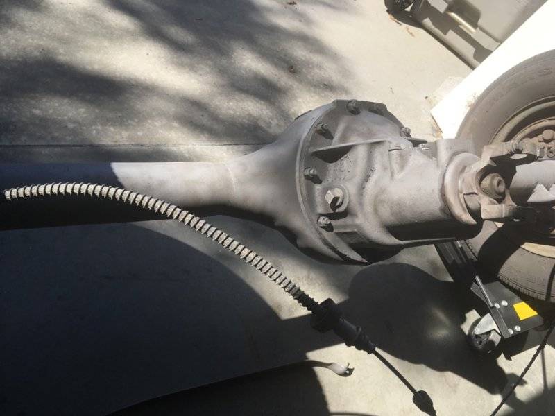

Hello Everyone!
Thank you all so much for the help! Although it has been taking me longer than I wanted to get moving on this project, I have begun!

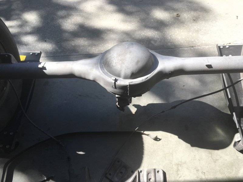

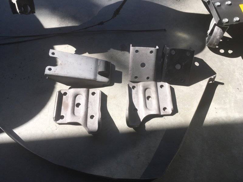

I started by cleaning everything I took off. I have included pictures of the final result. I sandblasted the rear end, the hangers, the leaf spring mounts, and the fuel tank strap. All seem to be in great shape and ready to be painted.
I took your guys' advice and contacted ESPO for rear springs. They were able to get everything I need. All of that is sitting ready to be installed.
I had a few questions regarding the rear end. A few people had mentioned that it is easier to work on the rear end if it is still on the car. My plan right now is to paint it and put it back on. Once it is on I want to do the seals, change the fluid and convert to disc brakes.
Is there anything I should be cognizant of while reassembling the rear end? Things that should be painted, things that shouldnt be? Things to watch out for?
When doing the pinion seal while the rear is in the car might be more difficult than when it's out. If you have a hoist it might be easier. If you're on jack stands, it's a little cramped under there for breaking and having to re torque the nut to 240 ft lbs.

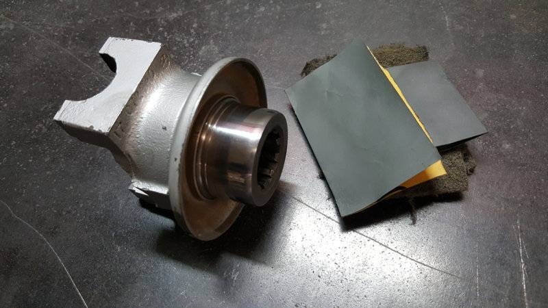

Torquing to 240 ft lbs I acually broke my torque wrench right when it clicked. I was outside the car standing on it. Notice the piece of angle iron I made to bolt to the yoke.
Used a puller to remove the yoke.
I didn't have any luck finding a good seal locally at any of the parts houses. All they had were the leather ones or a single lip rubber seal. I bought the best one, two row lip, from Dr. Diff.
When installing the seal, use a thin film of sealer inside the housing and also some sealer on the splines. The lube has been known to walk out through the splines.
I also polished up the yoke's seal surface. Scotch brite and 600
I bought a 3/4 drive socket for my 3/4 breaker bar because 1/2 BB would have broke. Needed 3' pipe on 3/4 BB to loosen. I'd buy the pinion seal from dr diff, you may not get the right one in a parts store. To hold the yoke used a 30" pipe wrench.
If you have grove in the yoke where the seal rides there's a $15 or so fix for that, speedi-sleeve.

When I swapped out my '63 Fury rear for a '65 Coronet after thorough cleaning applied POR 15 rust preventative paint a low gloss black. It's held up great after 15 + years. There was a pre-paint prep I followed, a solution that I think was a POR product as well.
