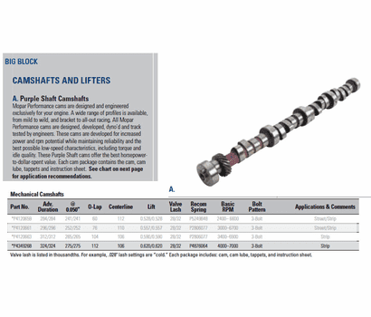

Will it work ok for my engine combo?
Bored 30 over 383 Magnum, forged crank and rods, 12-1 TRW L2293 dome pistons, 915 heads, Weiand tunnel ram, Milodon gear drive, and Milodon oil pan
Car has 4.11 gears and it's setup for E85
Will it be streetable with E85? I have plans to get a gearvendors in the future.
That is a lot of duration for a 383...even w 12:1. That particular cam is going to need a good set of heads, 5k+ stall and 5.13s in a tunnel ram 383. You can get that much lift or more with less duration with a different grind. I would not get a MP cam anymore, there are better grinds available that can be bought cheaper and ground using better technology.. Mp is living off their heritage from 30 years ago to sell cams. We have tons of better options. 4.10 is not that low of gear in a 383. You can over cam it pretty easily. High compression helps. I highly recommend figuring what the compression is first.
Aftermarket rods or oem? What transmission?
Fairly weak TQ even in a 13:1 440.
Decent top end power, but not earth shattering.
Probably wouldn’t be terrible in a high CR 383(13.5:1+)in a dragster or altered with a 6000 stall......... but wouldn’t be great either.
Measured duration @.050 is 283.
I wouldn’t even consider it in a 383 for a heavy door car.
It won’t like to be run with mufflers at all.
