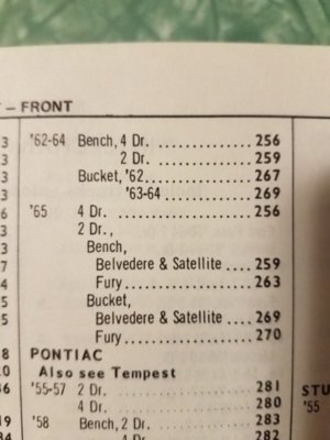

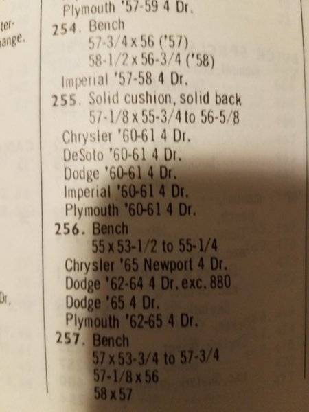

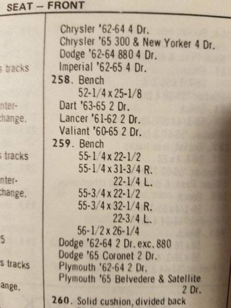

Hollander shows the front bench will not interchange between the 2dr and 4dr. Says nothing about the rear seat. 62-65 all interchange, just a diff between the 2 & 4 dr cars.
There's more. Hollander shows 5 different sizes (see pic)
