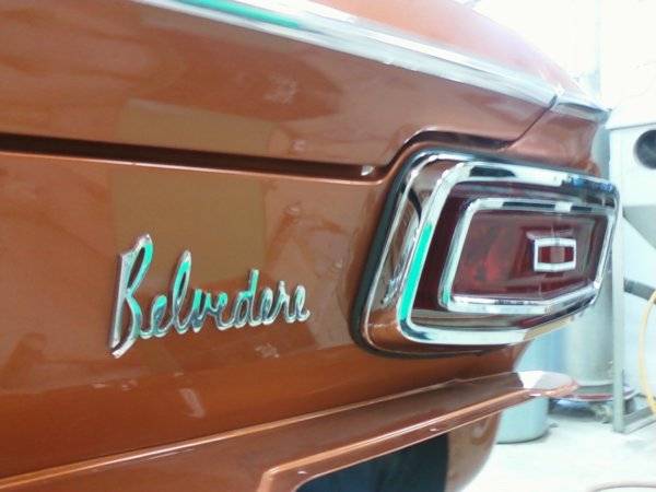

The parts on my 64 Plymouth were rechromed the day before repops were released. They're pretty good but not perfect. Cost me $500 6 years ago.

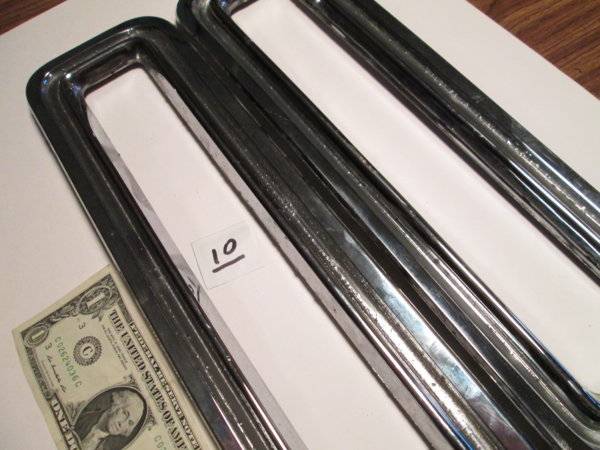

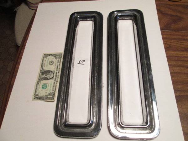

Well, my chrome pieces showed up yesterday, after I sent them back in the summer for re-work, as they were pitted & blistering with the "new" chrome applied. Really disappointed with the workmanship, as they are still pitted & blistering ! There are areas on the pieces that need to be detailed by painting black, and they said to "fill" these spots before painting. I was under the assumption that the "fill" should be applied before the new chrome, so it results in a smooth finish. If anyone knows what to use on these pieces to fix them, I would appreciate any feedback. And by the way, the Chroming Company doing the work was "Advanced Plating", out of Nashville,TN. NOT on my recommendation list...
Hate to see that **** happen.We don't mind paying the top dollar if we get the perfect part back!:mad:
I suppose I 'really lucked out' on my 64 tail light housings. Had three sets, all badly pitted, cracked, or both. For the cost, repairing, or find others, I located some pull-offs in Arizona. Like new, not cheap, but got 'em anyway. Cost to repair ran the same $s.
Don't know if it's EPA related...but, my understanding is, after all the corrosion is removed, should be copper flashed. With that, the pits are filled in, shaped until smooth, final copper flash if needed. Then the chrome.
Though, admit, it takes a good hand to polish out the chrome, or it can get screwed up.
Had one vent window frame, repaired, re-chromed, and screwed up, by the polisher. He polished out all the detail edges on it! Luckily, I had a spare, and used it.
Chrome only electroplates to nickel, which electrplates to copper, which plates to steel or die cast parts. So, to rechrome a part that is damaged, all the old finishes need to be removed down to original base material. Some blast, or even grind the finish off. That’s where you lose detail on steel or die cast parts, in the stripping of the old finishes. On die cast, I believe the pits are ground out and silver soldered, then copper plated. The copper layer is sanded, polished, even plated and polished again as many times as required, until perfectly smooth, then nickel plated, then chrome. The copper layer is most critical for the end result. With bumpers, I’ve heard double nickel, triple chrome, for a good quality part. I’m no expert, but only going by what I have been told over the years.
