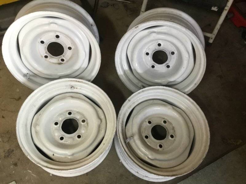

Looking to buy stock(ish) wheels for my 63 Polara. There are some 14-inch 5 x 4.5 bolt pattern/3.5-inch backspace wheels for sale locally, but the seller doesn't know what vehicle they came off of.
I know the rim size and bolt pattern are correct, but I don't know about the backspace. Also, the ad says there is 10 1/4-inch distance between "hubcap mount ridges."
Anyone know if this will fit my application or if these are in fact Mopar wheels? Thanks in advance.
Those maybe Ford wheels, Mopar wheels have 3 mounting nubs. Backspace should be ok just check the register hole in the center to be sure it will fit the axle/hub some of the Ford wheels have a larger register hole.
Your car should take a 9-3/4" ID cap. The wheels that I have that take those caps only have three nubs. They may be truck wheels. Is there a part number and Pentastar stamped in the wheels?
