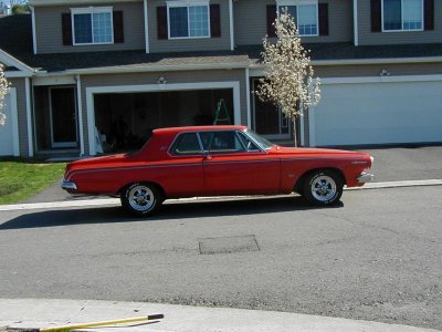

I bought the 3400 lb SS springs from Mancini and put them on my 63. This is how it sits which is just how I like it. They are the same leaf springs an A-body takes. Ron
These are the same ones I bought...:headbang:
Another set from Mancini of this one too..

Here is another pic I took 2 weeks ago of my 63 with the Mancini 3400 lb SS springs and they have been on the car for about 5 years with no sagging. Ron
Yes it is still sitting just the same as it did when I put these 3400 lb springs that are the same size as the Dart A-body springs. I have raced the car with them and drove it alot over the last 5 years. This pic was also taken about 2 weeks ago. Ron
