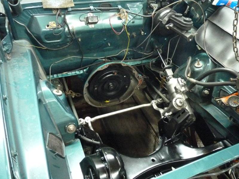

check the crossmember if it have the motor bracket like mine you just need the motor mount from schumacker
