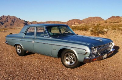

My 64 Belvedere 318 Weiand intake, 600 AFB, dual exhaust and 2.76 gear.28'' tall rear tire.Easy 18-20 mpg.Now for me most all roads are open highway very straight with small hills no mountains, ruff terrain or snakey switch backs. Where you live will make a difference.

Romeo, Where did you get that beautiful car?
Nice car Darter6! Thought about doing a 383 swap but then found out by doing some research that I may have a 2.76 rear end gear. Waiting on pulling the chunk out and checking. I'd like to keep it all original. We have some hills here in Ky. Car won't be driven a whole lot due to me having a couple of other vehicles. Mostly going to car shows via the interstate and parkway.
Stupid,stupid me.I got that car with 12K miles on it and owned it for 9 years.Sold it with 17k on it to a guy that wanted a 4 door for the wife and kids to cruise instead of them crawling into his Road Runner's back seat.I sold my drag race Dart and wanted to race again.Stupid,stupid me...........
