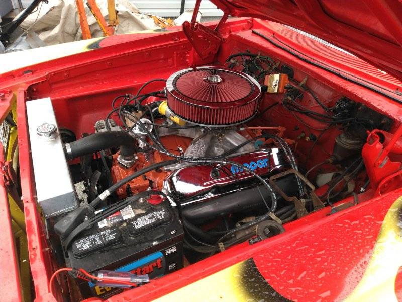

I was able to get everything in. Had to customize motor mounts & transmission mounts. No matter what I could come up with the stock column shift will not work. Floor shifter it's going to be. The throw difference between the column and the linkage on the transmission are way too different.

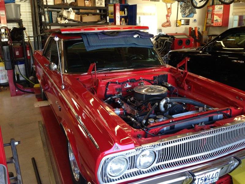

No, mine doesn't look anything near as pretty as that. But it's what I can afford.
