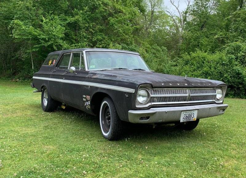

I just went with a Winters Sidewinder gated shifter when I converted my wagon. I love it.
