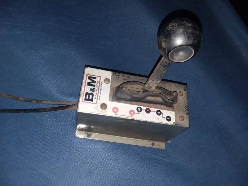

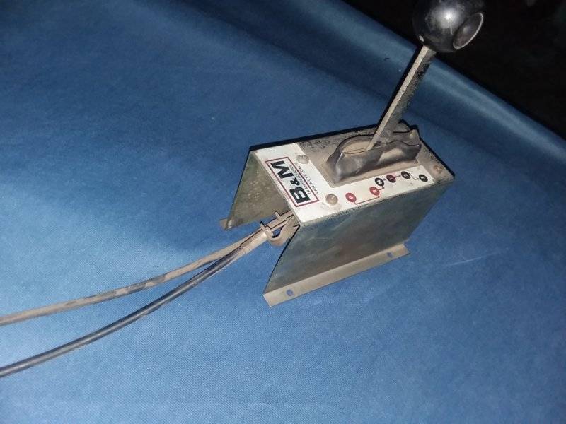

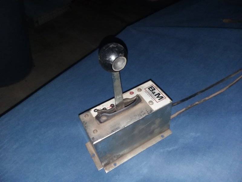

Yes IF you have a forty year old chrome box b&m. It will have two cables out of the shifter.
I have one but it is not for sale. I can post a picture, but not till early next week.
The chances are , if you have a floor shifter made in the last twenty years, and you have a park, you have a later, non-push button trans.
Easy way to tell, look at the drivers side of the trans and see if there's a cable going into the side of it. That would be the older trans. If there isn't a cable, you have the newer trans. Open the hood and look down along that side of the trans.
@44070dart, this is my B&M chrome box push button shifter. As you can see, it needs LOTS of chrome polish. (Please excuse the lousy photos. In the dark, lousy phone camera and lousy photographer).
Never seen a box like that..Yeah my trans is a later model 727 ..now when I sell the car I'll know what I'm talking about. Hate to get corrected by a mopar guy while selling, and have him think I'm trying to pull something about being original. thanks
