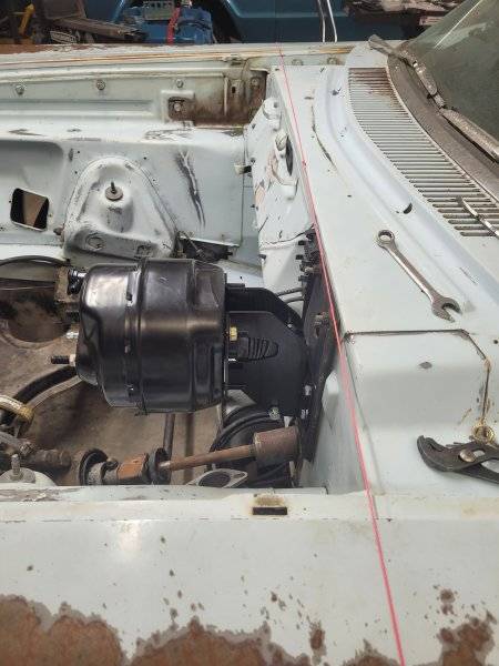

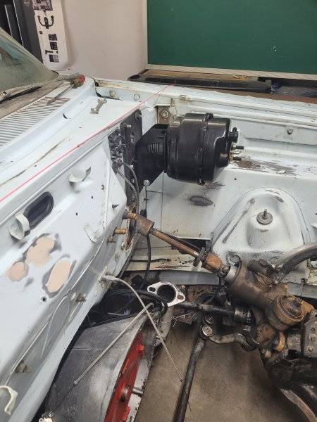

Quick update. I received my new Booster/MC from Pirate Jack Saturday and mocked it up. After trying all three of the levers that came with it I think I have the correct brake pedal ratio. I stretched a sting across the fenders/cowl area because of the height. It actually does protrude slightly above the fenders but after getting help setting the hood on it appears to fit. It does have a little "Rock" in it around the booster but the hood needs to come up about 3/8 of an inch in that corner. When I looked through the grille opening the hood insulation is pressed. Pirate Jack assured me it would fir so... I hope to get the engine bay painted this week and start reassembling everything
You could slot the booster bracket to firewall to lower it 1/8''-3/16'' without any booster push rod problems.
