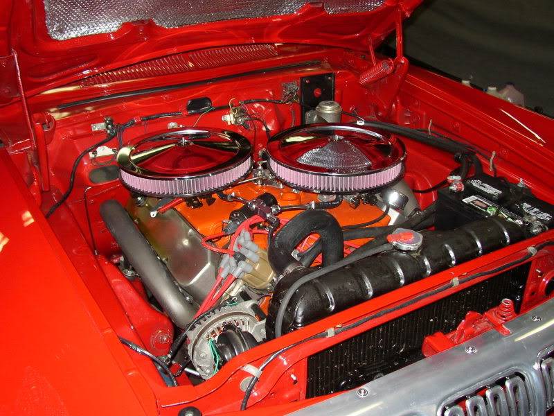

A 426 would be worth the money for someone who's looking for a numbers matching car. Also the block, if original, is worth lots of money to racers running in that class that needs original 426 motors. I don't know how close you want a builder to be to your place but you do have Ray Barton in Robesonia in SE PA. I had my max wedge (using a '68 440 block) built by Carl Ruth located in Reading, PA.

As was said its cheaper to build the 440 because many places stock the parts but not for the 426. I used a 440 block and went with a 440Source stroker kit which worked good for me. The 426 can be built and stroked but it will be more work and money then just getting a 440 block. Good luck to you. Ron
