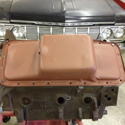

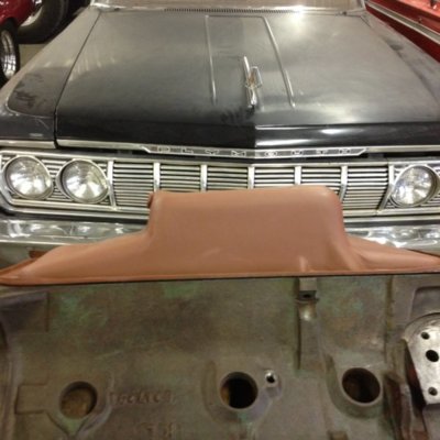

Here's some pics of the pan I have. I matched it up to the Milodon I had planned to use, and it looks like it should fit the '63-'65 B-Bodies, with some added oil capacity. The only thing I'm questioning is the added depth to the rear galley, as whether it will clear the center link ? I checked the clearance on my friends '65 Hemi Coronet, and looked close, but clear...
I've never seen that pan before, no idea what it came out of. That deep rear section is unusual for a Mopar.

Here's some pics of the pan I have. I matched it up to the Milodon I had planned to use, and it looks like it should fit the '63-'65 B-Bodies, with some added oil capacity. The only thing I'm questioning is the added depth to the rear galley, as whether it will clear the center link ? I checked the clearance on my friends '65 Hemi Coronet, and looked close, but clear...View attachment 742484 View attachment 742485 View attachment 742486 View attachment 742487 View attachment 742488

It's not a short sump, measures 5-1/2" Deep, plus the added depth to the galley. Should add at least 1-1/2 quarts to a standard pan. Easy way to find out is to fill it with H2O, and compare it to a standard pan, which is 4Qts. If some has a 4Qt Stock pan, we can get together, and do a Science Lab Experiment...

I'm wondering if this pan may be off an Industrial Hemi Torque Model, that were used in the Mid-60's, for Industrial applications ? I live up near Buffalo, NY, and they had 2 Hemis at the Calspan Facility, that used to do a lot of testing for many applications. The deep sump, and lack of baffles, might explain the extra oil capacity, for heat transfer purposes ? Those engines were Legends around here, and when they stopped testing, supposedly a Maintenance Tech picked both up for "Dirt Cheap" $$'s. Just a thought on the pan, and I didn't pick it up locally. I just saw they started producing a Max Wedge pan, which is what I was going to use this pan for, so I may have this one up For Sale soon...

i'm not referring to the depth but the length of the sump. normal length for the chassis is about 10". the depth of the back of the pan is mostly taken up by the crank and rods and isn't meant for capacity increse. you need to find a pic of a stock pan to understand what i'm saying or at least do a wet test of the sumps capacity.
