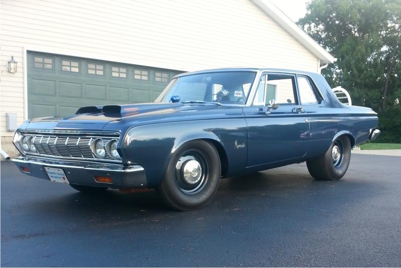

My 64 savoy is EE1 dk blue metallic.(poly)Yes it is metallic. 20140908_182616.jpg

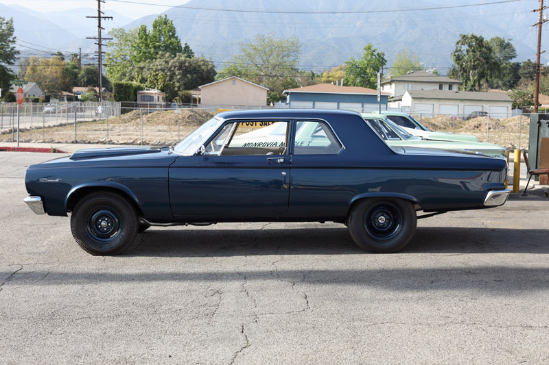

after i saw this 65 on Moshers site, i was hooked!

bluemaxsavoy... love that 64 plymouth. Absolutely beautiful!

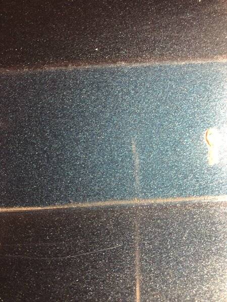

Ancient post but just to add some documentation for those that go searching... I'm re-painting my car and when I took off one of the chrome strips I exposed some nice original factory unfaded '64 EE-1. It's the one in the middle.
Yes, even though its an older thread thanks for posting the picture, i'm sure it will help someone in the future. I found out the hard way about how confusing mopar color names/ codes are when trying to look up my 64' codes.

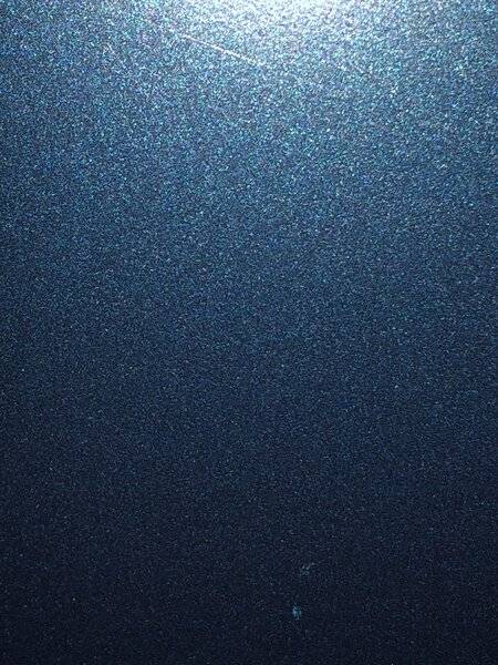

Sooo, part 1: Tried to order paint today. DCC and DBC don't have mixing formulas for 12657. MTK and MBC do, but of course those are Omni which often matches less well. Bought a 1/2 pint of MBC. I'll shoot that tonight and compare it to my remaining spots of original EE-1. Will probably go with it but will consider '68 EE-1 if I don't like it, they have DCC and DBC formulas for that.
This is the MBC sample on an extra deck lid. I’m going for it.
